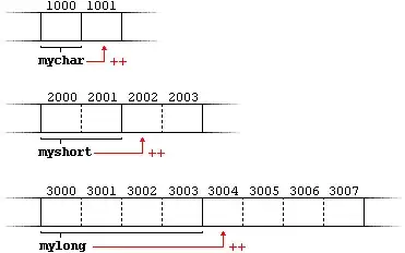

piHashVal = (uint64_t*)(result.bResult + 24);
result.bResult is a pointer to some data structure, it's storing the memory address at which the structure begins. We're not interested in the beginning of that data blob, but want to access some 64-bits starting at offset 24. The above expression increments the address by offset 24 and casts the result to pointer to uint64_t. This means that the expression *piHashVal will return value of those 64-bits, interpreted as unsigned int. Note about the offset, how much bytes it offsets will depend on the type of pointer result.bResult. See also: Pointer Arithmetic for Structs
Example when offseting pointers of different types
piNonce = (uint32_t*)(oWork.bWorkBlob + 39);
This does similar, only we're taking the 32-bits starting at offset 39 from beginning of oWork.bWorkBlob data structure.
*piNonce = ++result.iNonce;
Increment the result.iNonce by 1, and assign the resulting value to *piNonce which is the data stored at memory address piNonce. Note that both variables result.iNonce and *piNonce are changed here. By doing this, we surgically changed some 32-bits in the oWork.BworkBlob data structure since the piNonce points to a part of it and we accessed that part directly with *piNonce.
