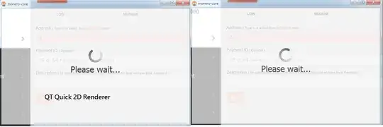

Allright, so far so good. but what does it really do ?
The different isnt that easy to spot, but for users on old machines it will make a big difference :-) you might notice the difference when comparing the font.
Here on the left side you can see it running with the Quick 2D Rendering Option enabled
