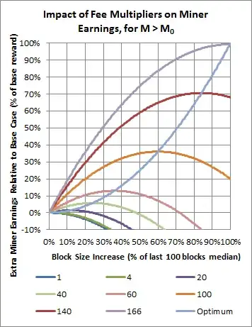

So we see how the min. fee gives some incentive to increase the blocks. But there are options to offer a multiplier of the minimum fee and there is an optimum block size increase for each wallet setting, as we can see below:
Impact of Fee Multipler on Miner Earnings
The "sweet spot" for the miner is where the optimum curve crosses any of the fee curves. That means, that in case of heavy network usage any backlog could be resolved: the more people compete with their fees, the faster it will be resolved.
