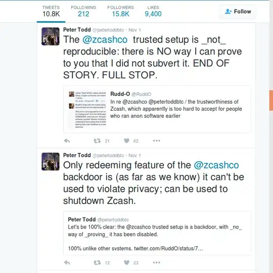

More information on the setup parmenters and risks can be found here. The ceremony to construct the zk-SNARK parameters involved the participation of 6 people. Since it cannot be conclusively proven that collusion did not (or will not) occur, Zcash users will have to decide whether or not the level of risk being "quite low" (according to Vitalik Buterin) is acceptable:
I actually recommended a different process for the trusted setup - my preference was to not bother with the airgaps, DVDs, offline laptops, etc and make up for it by having 20-30 participants instead of six and make sure they come from different countries, backgrounds, etc. I got this instinct from my experience managing the ethereum foundation wallet - our original setup was 3-of-4 but had lots of fancy secret sharing, encryption, offline signing and other machinery on each device but at one point it nearly broke, and since then we're using a 4-of-7 hot wallet between online laptops, and I feel much more comfortable with the security of the latter. But these are only my views, not shared by everyone, and others of course have different opinions how the risks and benefits should be balanced.
EDIT: just to be clear, I still personally think that the risks of the current setup having been compromised are quite low.
Peter Todd, one of the six participants in the Zcash trusted setup was more critical: enter image description here
