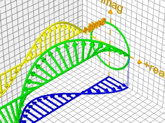

I hope This helps
I got this by googling
