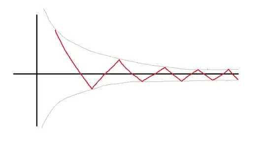

The fact is false. Here is a counterexample: enter image description here
You can smooth the corners so that $f'(x)$ is defined everywhere, but alternates between $+1$ and $-1$, so has no limit as $x\to \infty$. Meanwhile, $f(x)$ is squeezed between curves that approach zero, so $f(x)\to 0$.

  • It's not true, but would it be true for non-oscillating functions? And if so, how would we then prove it? – Axoren Oct 27 '14 at 03:23
    What does "non-oscillating" mean? You can make the red curve hug the top asymptote, then go at slope $-1$ to hug the bottom one, then up again. You can make this happen in a non-periodic way if you like, even at random, and the counterexample still stands. – vadim123 Oct 27 '14 at 03:28

  • but in the peaks of the function the derivative is not defined , if the derivative is defined in the interval $(0, \infty)$ the result is true ? or which condition is necessary for this? – Jhon Jairo Oct 27 '14 at 03:42
  • You can smooth the corners so that $f'(x)$ is defined everywhere; if you want an explicit function see @KajHansen's solution which is pretty much the red curve. – vadim123 Oct 27 '14 at 03:43
