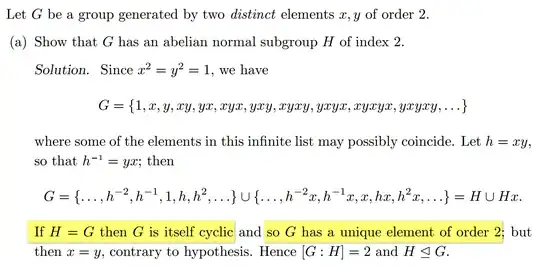

I met some problem during googling.
The problem and its solution are next.
and I'm wondering about 2nd YELLOW BOX
$$ $$ Why does $G$ have a unique element of order $2$ in case of $H=G$ ?
The next is "my opinion" for 2nd YELLOW BOX...
If $H=G=H \cup Hx$ , then $Hx=H$
So, $x=h^k$ for some $k \in Z-\{0\} $.
By hypothesis for $|x|=2$ , I get $|h^k|=2$.
Therefore $G=\{1, h, h^2, \cdots , h^k , ... , h^{2k-1} \}$, and $G$ has an unique element $h^k$ of order $2$.
Is my opinion RIGHT?
I thought and thought AND THOUGHT so many time for digesting YELLOW BOX.. :-(
By any chance... Is it trivial thing?
OR Do you have any good idea for understanding YELLOW BOX?
Could you give me some advice, please?
Thanks for reading my question.

You said that $Hx\subset H$, but remember cosets are disjoint or equal! So $Hx=H$. Then, remembering $H=\langle h\rangle$ where $h=xy$, and assuming $Hx=H$,
  • $y\in H$ as $h^{-1}x\in Hx=H$ but $h^{-1}x=y^{-1}$.
  • $x\in H$ as $1x\in Hx=H$ but $1x=x$.
Hence, $G=\langle x, y\rangle\leq H$, so $G=H$ as required.
As $H$ is cyclic, this means that $G$ is cyclic. Now, cyclic groups of order $n$ contain unique subgroups of every order dividing $n$$^{\dagger}$, from which the "unique element of order $2$" follows. Alternatively, note that the number $n$ has at most one integer that is one half of it...
$^{\dagger}$ See this math.SE answer for a proof of this fact.

There's a quick answer to this: If $H = G$, then since $H$ is cyclic (it is generated by the element $h = xy$), $G$ must also be cyclic. Since it is cyclic, it is in particular abelian. Thus $x, y$ commute.
So we have two possibilities.
  1. $x \neq y$
  2. $x = y$
You should be able to show that the first case is impossible since $G$ is cyclic. This leaves the second case, but this shows that there is only one element of order 2.
Edit This is not correct, as was pointed out in the comments. A better proof is that if $G$ is cyclic (by hypothesis, since $G = H$), then $G \cong \mathbb{Z}$ or $G \cong \mathbb{Z}/n$ for some $n$. In the first case, it has no elements of order 2, which obviously is not the case. In the second case, if $n$ is odd then there are also no elements of order 2. If $n$ is even, then you can check (try this with $\mathbb{Z}/6, \mathbb{Z}/8$ and a few others if you prefer) that there must be a unique element of order two, namely $[n/2]$. Since by assumption $x \neq y$, here is your contradiction.
