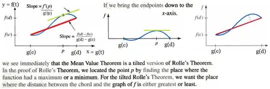

This picture can aid in intuition. from Cauchy's Generalized Mean Value Theorem. Required function. (S.A. pp 140 t5.3.5)
I parameterized the picture to question the Cauchy Generalized Mean Value Theorem, but you can ignore the $g(t)$ on the x-axis here. Ergo undo the parameterization by the agency of $g(t) = t$. Then $g(c)$ is veritably c, $g(d)$ is d.
