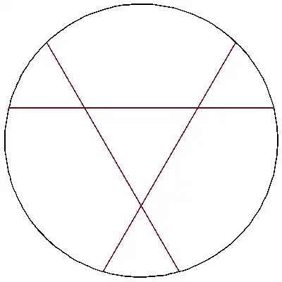

    Meanwhile, the 3/7 business cuts down the configuration space to, in effect, dimension two. Each line is a fixed distance from the origin. Fix one. The other two are given entirely by two relative angles. – Will Jagy Oct 20 '14 at 00:37
Each line splits the disk into parts of areas $3/7 A$ and $4/7 A$, where $A$ is the area of the disk, and that determines the distance $d$ from the centre of the disk to the line. The general arrangement has to be something like
where the intersection of two lines is in the $4/7 A$ region for the other line. In order for the three wedge-shaped regions to have the same areas, the angles between each pair of lines has to be the same (so $\pi/3$). That should be enough information to determine the area of the central triangle, say. If it's not $1/7 A$, you're done.

    Yes. For circle of radius 1, the distance of each line from the origin is $\delta \approx 0.112437096,$ the minimum area of the inner triangle is $\delta \sqrt{27} \approx 0.584240288,$ but $\pi/7 \approx 0.448798951.$ Th possible areas for the inner triangle are $\delta (\tan \alpha + \tan \beta + \tan \gamma )$ constrained by $\alpha + \beta + \gamma = \pi.$ Going to double check minimum vs. maximum for inner triangle. – Will Jagy Oct 20 '14 at 01:47
