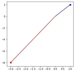

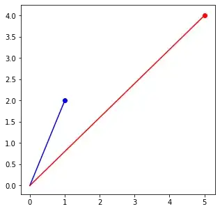

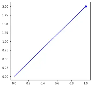

Let us take an example of a vector V = i + 2j which in matrix notation is
It will be represented as enter image description here
  • POSITIVE DEFINITE MATRIX
A positive definite matrix is
How do we know it is positive definite matrix
The altered vector is
  • POSITIVE SEMI-DEFINITE MATRIX
The altered vector is [0 , 0]
  • NEGATIVE MATRIX
The altered vector in this case is
We can see the quadrant has changed
  • why do we care if the quadrant has changed or not? Also how is the graph for semi-definite looks like? Can you please elaborate more on what do you mean by altered vector – GENIVI-LEARNER Feb 09 '20 at 14:53
