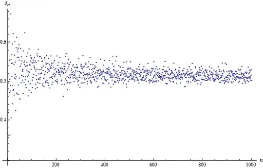

The behavior of $\delta_n$ is harder to get a handle on. Numerically it seems to tend to $1/2$ as $n \to \infty$, as can be seen from the following plot.
Because of this I would suspect that
$$ \frac{f(n)}{n^2} = 1 - \frac{\pi}{4} + o(n^{-1}) $$
as $n \to \infty$. Unfortunately without more information about $\delta_n$ this can't be made more precise.
The behavior $\delta_n \to 1/2$ is what we would expect if the summands $\left\{n - \sqrt{n^2-k^2}\right\}$ from $(*)$ were roughly uniformly distributed over the interval $[0,1]$. Perhaps this is the case in some specific sense, and I would be interested if someone could say something about it.
