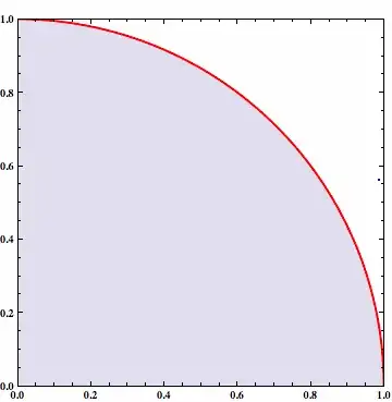

Then, I draw on a quarter-circle of radius 1 onto the unit square. It looks something like:
Now all there is to do is to generate a ton of random points within this area and then count the number of points hitting the violet region and divide by total number of points we threw. This will lead us to get closer and closer to $\pi/4$, and so all we have to do to find $\pi$ is to multiply by 4.

I first say that I will be working with $n$ such samples and that we will random and uniformly take a value from the x-axis, and then one from the y-axis. Then, we define a random variable for each random point that adds one for hitting the violet region, and 0 from hitting the white area:
$ b_k = \left\{ \begin{array}{l l} 1 & \quad \text{if} \sqrt{x_{k}^2 + y_{k}^2} \leq 1\\ 0 & \quad \text{otherwise} \end{array} \right.$
