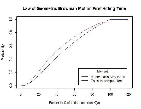

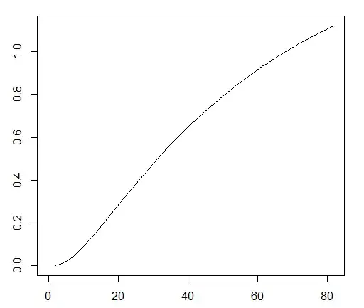

I'm having values bigger than one and an unexpected shape for the function $f(B) := \mathbb P [\tau_B \leq T]$ as you can see below in the graphic (Axes $y =f(B)$ and $x =B$; here X_0= 68).
I forced it to be 1 for barrier values equal or higher than the initial value. Nonetheless I think there is still a problem with the formula not only it should be automatically 1 for $B \leq X_0$. The probabilities I have calculating it by Monte Carlo are higher than the values obtained by this formula as you can see in the second graphic bellow.
