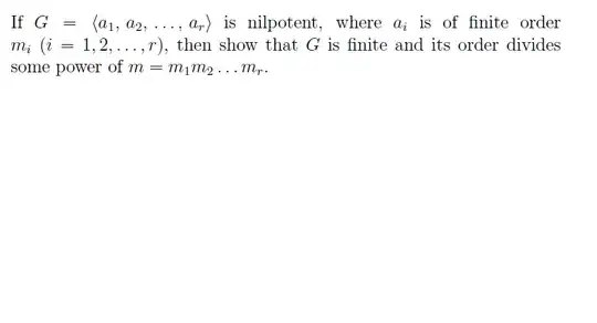

use this notation for the following $\textbf{Theorem}$ -
$\textbf{notation}-$ $G^n$ is the subgroup generated by $n$th power of elements of $G$
$\textbf{Theorem}$- In a finitely generated nilpotent group, $\cap{G^p}$, for any infinite set of primes, is finite,(follows by a paper of HIGMAN) does it help me to prove this question above. I don't think so.
Is it true, that a group generated by finite elements of finite order is finite. If it is true then to prove $G$ is finite in the problem is easy, and don not require nilpotency. But it should not be true, but what can be an example?

    Tarski monsters are examples of finitely generated groups whose generators have finite order. – Teri Sep 25 '14 at 17:41
  • so we need nilpotency to say $G$ is finite. How can i approach this problem? – Bhaskar Vashishth Sep 25 '14 at 17:43
  • Use induction on the nilpotence class, and consider the central quotient in the non-abelian case. – James Sep 25 '14 at 19:24
  • I can't use induction, until I show $G$ is finite – Bhaskar Vashishth Sep 25 '14 at 19:25
  • The fact that $G$ is finite is proved in the answer by Artuto Magidin to http://math.stackexchange.com/questions/79474 Since it is finite, it is the direct product of its Sylow subgroups, and it is easy to see that the only promes dividing $|G|$ are those dividing the order of one of the generators. (And the proof does use induction!) – Derek Holt Sep 25 '14 at 19:27
    @BhaskarVashishth The induction is on nilpotence class, which is finite by assumption. – zibadawa timmy Sep 25 '14 at 19:33
  • ohh yes. Induction on class. I am still reading Arturo's proof. let see which one will be easier. – Bhaskar Vashishth Sep 25 '14 at 19:34
  • @DerekHolt by Artuto's Proof only significant thing for me which I could find out was that in his theorem he proves that product of two elements of finite order is of finite order, which in my case tells that $G$ has all its elements of finite order. But $G$ can still be infinite? what I am missing, to see $G$ is finite?? – Bhaskar Vashishth Sep 25 '14 at 20:35
  • That's an easy induction on the class. The torsion subgroup true is finite for abelian groups and, for nonabelian groups, by induction both $G/Z(G)$ and $Z(G)$ are finite, so $G$ is finite. – Derek Holt Sep 25 '14 at 21:28
