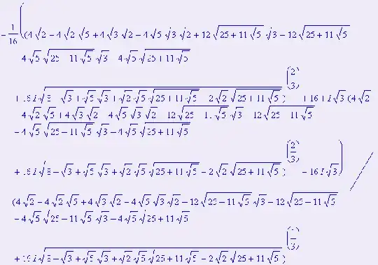

But, as my title suggests, $\sin(1^\circ)$ is irrational, (look at the following image for its value!) Sine 1 degree
Is there a proof as short as the above proof or can any of you help me with a proof that bypasses actual evaluation of the above value?
Image Courtesy: http://www.efnet-math.org/Meta/sine1.htm This link explains how to evaluate this value.
