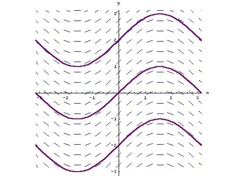

The key concept to note here is that when you differentiate a constant you get 0, this is due to the fact that the slope of the tangent line of a constant function, say $f(x) = 4$, will simply be a horizontal line spanning the x-axis with a slope of zero everywhere.
When you differentiate a particular function that has a constant at the end, say $f(x) = x^2 +2x +4$ to get $f'(x) = 2x +2$, you have no way, given only the derivative $f'(x)$, to recover the "constant information" about the original function.
This is precisely why you have to have a slope field representation of the anti-derivative of a function. When you integrate a particular function, you must add that $+C$ because it says that, the anti-derivative of the function could be one of any of the slope field lines in $\mathbb{R}^2$. The particular value for $C$ collapses it to exactly one of these slope field lines. Here is a graphical representation of a slope field and three particular values of $C$ that draw out the purple functions. The slope field anti-derivative is given by: $$ \int \cos(x) dx = \sin(x) +C$$
Antiderivative
The three purple functions drawn out are: $$f(x) = \sin(x) -2$$ $$f(x) = \sin(x) + 0$$ $$f(x) = \sin(x) +2 $$
It may also make more sense when you take a differential equations course, but this should be a sufficient explanation.

  • I aggree.That's why i included a simple differential equation which i solved.i'am sorry.i took a long time to edit. – alok Dec 26 '11 at 18:07
  • So, is there anything that I can add to my answer that you still have a question about? – Samuel Reid Dec 26 '11 at 18:19
  • Right.I've just started with differential equations and this slope field is yet to make sense,however i will try to comprehend.By the way which tool do you use to draw slope fields?I'am sure that it'll come in handy when i get there. – alok Dec 26 '11 at 18:31
  • I got this picture off of a university website, but for any sort of figure drawing, I use Adobe Illustrator CS5 for figures in all of my papers. Another way of thinking of the slope field is that it covers the plane with all of the possible "flow lines of the function", so if you have water running down a stream (think of this as from -x to +x), the water will run along the paths described by the slope field. Values for $C$ correspond to what particular path the function (or the water) is running along. – Samuel Reid Dec 26 '11 at 18:38
