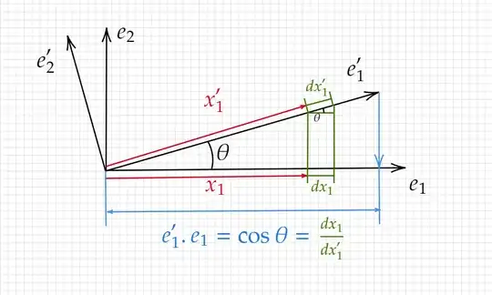

For $R^2$ it is easy to visualize. You can extend it to $R^3$. The thing to note is that the projection of one unit vector on another unit vector is the cosine of the angle between them.
$e^{'}_v.{e_{\mu}} = |e^{'}_v|.|e_{\mu}|\cos{\theta} = \cos{\theta}$ , where $\theta$ is the angle between unit vectors $e^{'}_v$ and $e_{\mu}$.
Now, refer to the image attached.enter image description here
The partial derivatives come into play when we do something similar in $R^3$.
