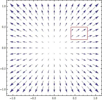

On the other hand the vector field $\vec{g}$ looks like the following:
Here we see that the flow is aways from both axes, and actually is away from the origin. If we again look at a small rectangle somewhere in the first quadrant this time we see that the outflow through the top wins the inflow at the bottom, and ALSO the outflow to the right wins the inflow from the left. Overall more stuff is flowing out than what's entering = positive divergence.
