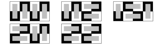

The identity from the question can be viewed in a completely different way.
First, Fibonacci number of order n can be defined as number of ways for 2×1 dominoes to cover a 2×n checkerboard:
n=3:
n=4:
n=5:
Then, one can use methods presented in this paper to prove the original identity.
