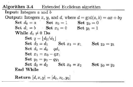

EEA will find the GCD(m,n) where
z = a mod m
z = b mod n
We can use EEA to compute CRT. The complete tutorial is found here Solving Congruences: The Chinese Remainder Theorem
From what I understand, given a system of congruence equations, we can find a general solution to the system by:
[1] Compute the gcd of the first two z to find the expression  (m*x0) + (n*y0)
[2] Construct a new z based on [1], where
       z_new = (m*x0)*b + (n*y0)*a  mod (m*n)
[3] Compute the gcd of z_new and the third z
[4] The final z that satisfy the system is again
       z_system = (m*x0)*b + (n*y0)*a  mod (m*n)
