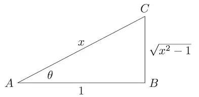

$$\tan \left(\sec ^{-1}(x)\right)$$
I know that sec(?)=$\frac{x}{1}$ and that sec=hyp/adj, therefore I conclude that hyp=x and adj=1 and that op=$\sqrt{x^2-1}$
Since Tan = opp/adj I thought the answer was the same as op. However I do not understand how this is done? cause my conclusion is wrong! The answer provided is this:
ALEXANDER
  • 2,160
In this triangle, we have:
$$\sec(\theta)=\frac{\text{hypotenuse}}{\text{adjacent}} \Rightarrow \theta=\sec^{-1}\Big(\frac{\text{hypotenuse}}{\text{adjacent}}\Big)$$
In your problem, $\theta=\sec^{-1}(x)$, so $\text{hypotenuse}=x$, $\text{adjacent}=1$ and $\text{opposite}=\sqrt{x^2-1}$ (Pythagorean Theorem).
Hence, $$\tan(\sec^{-1}x)=\tan(\theta)=\frac{\text{opposite}}{\text{adjacent}}=\dfrac{\sqrt{x^2-1}}{1}=\boxed{\sqrt{x^2-1}}$$

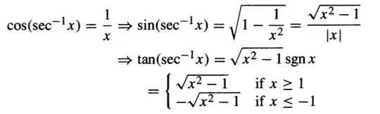

Hint $$ \tan^2 u + 1 = \sec^2 u $$ and $$ \tan u = \pm\sqrt{\sec^2 u -1} $$ Can you see what happens when you place $u = \sec^{-1}x$?
