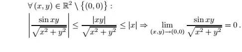

enter image description heremy solution ${}{}{}{}{}{}{}{}{}{}{}{}{}{}{}{}$

Note that $\forall (x,y)\ne (0,0)$ we have $$0\leq \left|\frac{\sin xy}{\sqrt{x^2+y^2}}\right|\leq \frac{|xy|}{\sqrt{x^2+y^2}}=\frac{|x|\cdot |y|}{\sqrt{x^2+y^2}}\leq \frac{\sqrt{x^2+y^2}\cdot |y|}{\sqrt{x^2+y^2}}=|y|, $$ i.e., $$0\leq \left|\frac{\sin xy}{\sqrt{x^2+y^2}}\right|\leq |y|, $$
and as $$\lim_{(x,y)\rightarrow (0,0)}0= 0 = \lim_{(x,y)\rightarrow (0,0)}|y|=0, $$ for the sandwisch theorem follow that $$\lim_{(x,y)\rightarrow (0,0)}\frac{\sin xy}{\sqrt{x^2+y^2}}=0. $$
