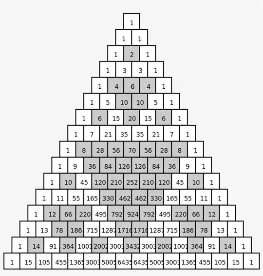

Just normalize the expected hitting values (# of times process obtains a given integer) of a simple one-dimensional random walk on $\mathbb{Z}$.
This is equivalent to shifting the binomial distribution $B(n,\frac{1}{2})-\frac{n}{2}$, modulo any little odd/even parity issues. Which is why the normal distribution, $N(n,\frac{n}{4})$, is used as an approximation for the binomial distribution.
It is easy to get intuition for why this works by glancing at Pascal's Triangle (the binomial expansion). In other words, if you have say 7 ordered objects which you want to approximate a normal distribution over selecting, just normalize the coefficients of the binomial expansion with exponent $n=7$. Or normalize the seventh row of Pascal's Triangle.
