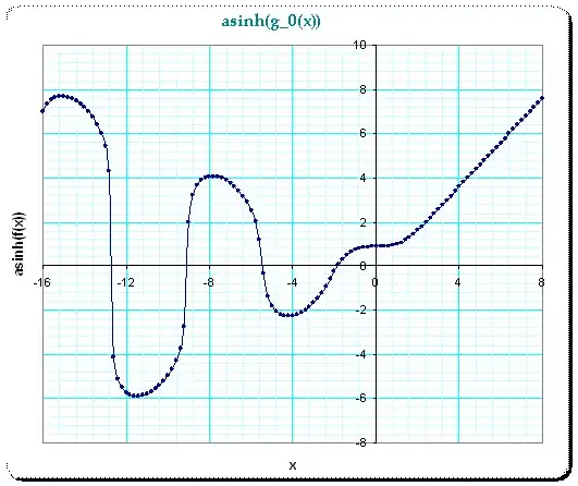

Here is a picture of $g_{0}(x)$ over the reals:
The picture shows already that like with the $\cos^{[-1]}(x)$ and $\cosh^{[-1]}(x)$ we'll have very limited ranges for the inversion due to its multivaluedness and singularities in its derivatives.

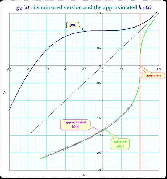

A first -seemingly- practicable way; someone might correct me if I'm going wrong in the following. But see also the answers and remarks of Ioannis Galidakis which point out that any solution should have serious problems. However, it is still a description how things can be developed in principle.
To save notation I use $g(x)$ for $g_{0}(x)$ and $h(x)$ for its inverse.
First we need a function which is -by whatever means- able to give approximate values for the true $h(x) = g^{[-1]}(x) $. We can implement it using binary search or Newton-iteration or whatever; I used the Pari/GP-facility $\operatorname{solve}()$.
Because the Taylor/McLaurin-series of $h(x)$ shall be written as $$h(x) = h(0) + h'(0) \cdot x + h''(0)/2! \cdot x^2 + h^{(3)}/3! \cdot x^3 + ... + h^{(k)}/k! \cdot x^k + ...$$ we need the derivatives at $h(0)$. Because $g(x)$ has real roots $\rho_k \ne 0$ (see the list below), that desired centering of $h(x)$ around zero is possible.
Now from $h(0) = \rho_0 $ the inverse were $g(\rho_0)=0$ and we use $\rho_0 \approx -1.849812 $ being the first root of $g(x)$ near the origin.
After that, the first derivative of $h(x)$ at zero can be approximated by the standard-formula
$ \displaystyle \qquad \qquad \begin{eqnarray} h^{(0)}(x) &=& h(x) \\ h'(x) &=& {h(x+\delta/2)-h(x-\delta/2) \over \delta } \\ h''(x) &=& {h(x+\delta)-2 \cdot h(x) + h(x-\delta) \over \delta ^2} \\ \cdots &=& \cdots \end{eqnarray} $
and the approximations for the higher derivatives using the standard procedure with the binomial coefficients can similarly be applied. Unfortunately we need a lot of internal digits precision because the higher derivatives need powers of $\delta$; if we use $ \delta =10^{-40}$ we need all calculations with precision of at least 1600 digits if we want up to $32$ derivatives.
The result, using the mentioned parameters for internal precision and number of terms $n=33$ we get the following series:
$$ \begin{eqnarray} h(x) &=& -1.84981279919 \\ && + 0.651979598821 x \\ && + 0.190746124496 x^2 \\ && + 0.111611111992 x^3 \\ && + 0.0741048566240 x^4 \\ && + 0.0545378390754 x^5 \\ && + 0.0424543985801 x^6 \\ && + 0.0343968565970 x^7 \\ && + 0.0286795136369 x^8 \\ && + 0.0244408507981 x^9 \\ && + 0.0211888354521 x^{10} \\ && + 0.0186252446226 x^{11} \\ && ... + O(x^{32}) \end{eqnarray} $$ $\qquad \qquad$ see more terms below
This basic procedure can be optimized a bit for precision, programmability or readability; differences by three different implementations occur beyond the 40'th decimal digits of the numbers.
However, the range of convergence/applicability is very limited: we can use it at most for $\rho_0 < x <1$ . The image below can show this for the intuition, where the slope of the $h(x)$ becomes a singularity at $x=1$:
Nevertheless, with 33 terms I can reproduce $y=g(h(x)) $ for $x=0.5$ to $y=0.49999$ and for $x=0.25$ to $y=0.250000$ and a couple more of such values of course with $|x|<1$.
Another view into the problem of accuracy is to compose the function $g()$ with its inverse but let the argument indeterminate. By this I get (using the truncated series up to 33 terms)
$ \displaystyle \begin{eqnarray} g(h(x)) &=& -8.00000000000e-40 \\ && + 1.00000000000 \cdot x \\ && + 1.71188043604 e-41\cdot x^2 \\ && + 1.65691494789 e-41 \cdot x^3 \\ && + 1.66874548399 e-41 \cdot x^4 \\ && + 1.66622618083 e-41 \cdot x^5 \\ && + 1.66675967117 e-41 \cdot x^6 \\ && + 1.66664707455 e-41 \cdot x^7 + O(x^8) \end{eqnarray} $
which surprisingly uncovers nicely that I have used $\delta=1e-40$ for the determination of the derivatives....
I've not yet an exact description of the coefficients; a quick check suggests, that the sequence of 4'th differences of the third powers of the reciprocals of the coefficients might converge to a constant value. [/update]

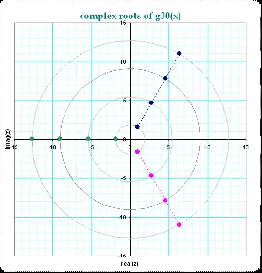

and here are the first couple of real roots:
    k     real root      r(k)*sqrt(3)         distance to the
              r(k)       /(2*Pi)              half integer
    0  -1.84981279919  -0.509927623657        -0.00992762365730
    1  -5.44123335502   -1.49995458768       0.0000454123212960
    2  -9.06899753487   -2.50000019674    -0.000000196741850967
    3  -12.6965955465   -3.49999999915  0.000000000852566088823
    4  -16.3241942781   -4.50000000000       -3.69452735821E-12
    5  -19.9517930066   -5.50000000000        1.60099406291E-14
    6  -23.5793917350   -6.50000000000       -6.93778050857E-17
    7  -27.2069904635   -7.50000000000        3.00643203496E-19
    8  -30.8345891920   -8.50000000000       -1.30281342422E-21
    9  -34.4621879205   -9.50000000000        5.64563841318E-24
   10  -38.0897866489   -10.5000000000       -2.44649252916E-26
   11  -41.7173853774   -11.5000000000        1.06016809034E-28
and the first few complex roots in the upper halfplane.
    real            imag
  0.924906399595  1.60198487634
   2.72061667751  4.71224631337
   4.53449876744  7.85398225206
   6.34829777327  10.9955742849
   8.16209713906  14.1371669412
Note, that the points seem to form a perfect straight line with slope of $\sqrt3$ and that the distances approximate quickly a constant (here the differences of the cartesian coordinates are shown):
    real            imag
   1.79571027792  3.11026143703
   1.81388208992  3.14173593869
   1.81379900584  3.14159203283
   1.81379936579  3.14159265628
The roots in triples of real and conjugate complex values are obviously triples of third roots of purely real negative numbers. The distances of the real roots seem to be extremely well approximable by a linear function of their indices, but I've not yet done the final conclusion.

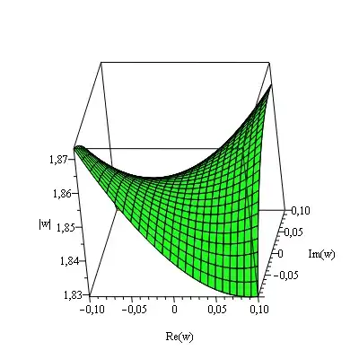

First the actual inverse:

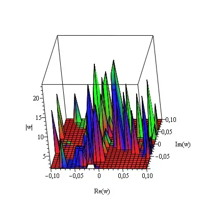

p1 := complexplot3d(evalf(H(w)), w = w0-.1-.1*I .. w0+.1+.1*I, axes = BOX)
display(p1)

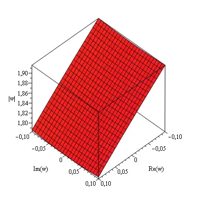

Next, the approximation:
p2 := complexplot3d(Hsp(w), w = w0-.1-.1*I .. w0+.1+.1*I, axes = BOX)
display(p2)
Obviously any approxiation around such a badly behaved $H$ will be nonsense. Note that $H$ is full of singularities (at least) and there are at least four branch cuts passing through the graphed range, so chances are $w_0$ is a branch point. Some of the other features may be discontinuity from passing to other branches, etc.

can be plotted so you can see what exactly it does. So:
h := proc (x) options operator, arrow;
-1.84981279919+.651979598821*x+.190746124496*x^2
+.111611111992*x^3+0.741048566240e-1*x^4+0.545378390754e-1*x^5
+0.424543985801e-1*x^6+0.343968565970e-1*x^7
+0.286795136369e-1*x^8+0.244408507981e-1*x^9
+0.211888354521e-1*x^10+0.186252446226e-1*x^11
end proc
and the plot:
p3 := complexplot3d(h(w), w = w0-.1-.1*I .. w0+.1+.1*I, axes = BOX)
display(p3)
And sorry to say, but this doesn't look like anything close to $H$, at least close to an $\epsilon\sim 0.1$ neighborhood of zero.
The $\mathbf{key}$ point being, you have to choose your expansion points diligently, when you are using either LIT or Taylor's Theorem for such expansions. With your example, you are choosing to expand into a series, amidst a forrest of singularities and branch cuts and points, so any such approximation is at least suspicious.
