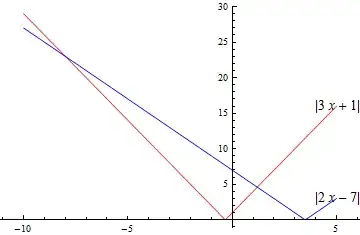

EDIT 2: another visual aid for simple cases like this is to plot both the left hand side and right hand side. This is another way to make sure you understand how the absolute value function works. You should get something like this:
Now, you are interested in the values of $x$ where the red line is above the blue line.
