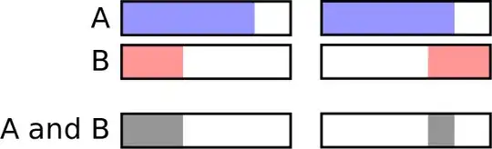

Consider two subjects first. Suppose a certain fraction take subject A and another fraction take B then we can imagine shading in a bar with those fractions:
Then we are free to 'shift' these two colours so as to minimise the overlap.
Once you can solve this for two subjects then JiK has explained how to solve it for an arbitrary number.
