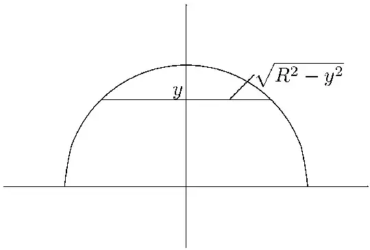

Volume of spherical cap using Cavalieri's principle:
We want to compare the volume of hemisphere (of radius $R$) and part of the cylinder outside the cone (both cylinder and cone have height and radius of the base equal to $R$).
See the following picture or a nicer picture at wikipedia from the article on Cavalieri's principle.
Note that area of the cut in the height $y$ is in both cases the same:
For the sphere, we get in the height $y$ a circle of radius $\sqrt{R^2-y^2}$, hence the area equals $\pi(R^2-y^2)$.

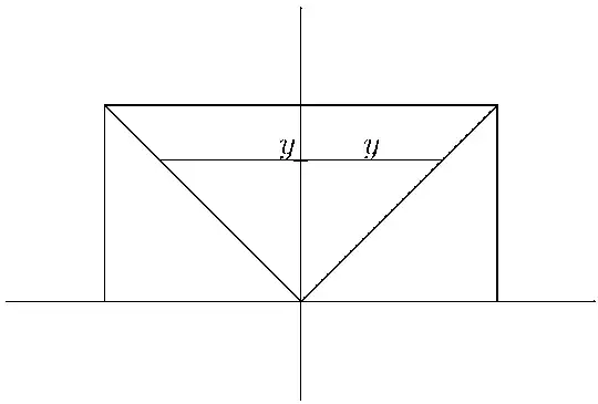

In the other body (difference of cylinder and cone) the cut at the height $y$ is the area between two circles with radii $R$ and $y$, hence the area is $\pi(R^2-y^2)$, which is the same as for sphere. (See the following picture.)
Hence: volume of the hemisphere = volume of the cylinder - volume of the cone: $$V_{1/2\text{sphere}}=V_{\text{cyl}}-V_{\text{cone}}$$
$$V=\pi R^3 - \frac 13 \pi R^3 = \frac23 \pi R^3$$
