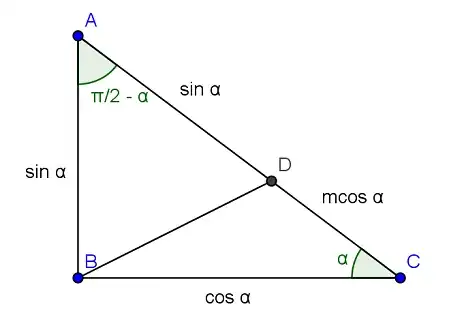

Since we are adding different proofs, here is a geometric one, for the special case when $m > 0$ and $\alpha$ is acute.
We use the Law of Tangents which states, that in a triangle
alt text
the identity
$$ \frac{a-b}{a+b} = \frac{\tan\frac{\alpha - \beta}{2}}{\tan\frac{\alpha+\beta}{2}}$$
holds.
Now consider the below triangle
We have $\displaystyle \angle{BCA} = \alpha$, $\displaystyle \angle{CBA} = \pi/2$ and $\displaystyle \angle{CAB} = \pi/2 - \alpha$.
ABC is a right angled triangle with $\displaystyle AC = 1 = m\cos\alpha + \sin \alpha$. Point $\displaystyle D$ is chosen on $\displaystyle AC$ such that $\displaystyle AD = \sin \alpha$ and so $\displaystyle DC = m\cos \alpha$. We also have $\displaystyle BC = \cos \alpha$ and $AB = \sin \alpha$.
Now $\displaystyle AD = \sin \alpha = AB$ and so $\triangle ABD$ is isoceles and hence $\displaystyle \angle{ABD} = \angle{ADB} = \pi/4 + \alpha/2$.
Thus we have that
$\displaystyle x = \angle{CDB} = 3\pi/4 - \alpha/2$ and $\displaystyle y = \angle{CBD} = \pi/4-\alpha/2$
Now apply the law of tangents to $\displaystyle \triangle BCD$.
We get
$$\frac{\cos \alpha - m\cos\alpha}{\cos\alpha + m\cos\alpha} = \frac{\tan (x/2 - y/2)}{\tan(x/2 + y/2)}$$
$$ = \frac{\tan(\pi/4)}{\tan(\pi/2 - \alpha/2)} = \tan(\alpha/2)$$
Thus
$$\frac{1-m}{1+m} = \tan(\alpha/2)$$
