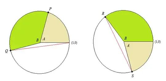

Hint:
Suppose that the two unit circles in the diagram are centered at the origin, with the second one rotated clockwise by $\measuredangle A$. Note that the two red line have equal length. Find the coordinates of $P,Q,R,\text{ and } S$ (but especially $Q$). Use this information to derive $\sin(A+B)$ and $\cos(A+B)$.
- 8,060
point $P$ has coordinates $(\cos A, \sin A)$. What are $Q,R,$ and $S$'s coordinates? – John Joy Aug 29 '14 at 12:33
