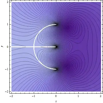

A graph of the function $f(z) = \log{(z+1/z)}$ helps to understand the difficulties:
where $|f(z)|$, $z = x+i y$ is plotted and the white path shows where $f$ is not holomorphic.

    You cannot integrate $$z\mapsto \frac{\ln\left(z+\frac{1}{z}\right)}{z}$$ on ${z\mid |z|=1}$ because the function is not holomorphic in ${z\mid |z|\leq 1}$, indeed, the function is not holomorphic for $\Re\left(z+\frac{1}{z}\right)<0$ – idm Aug 26 '14 at 14:11
  • Then, the conditions for applying residue theorem are not met? From Wikipedia we are told: "Suppose $U$ is a simply connected open subset of the complex plane, and $a_1,...,a_n$ are finitely many points of $U$ and $f$ is a function which is defined and holomorphic on $U \setminus {a_1,\ldots,a_n}$. If $\gamma$ is a rectifiable curve in $U$ which does not meet any of the $a_k$, and whose start point equals its endpoint, then (residue theorem expression follows)". Residue theorem contemplates that $f$ may not be holom. on $z=0$. What am I missing? – Dmoreno Aug 26 '14 at 14:17
  • Ok ok, I see it now. This function is not holomorphic in the path of integration and therefore residue theorem is not applicable here. A plot of the absolute value of the numerator helped me a lot. Thank you very much @idm. Put your comment as part of your answer and I will accept it. – Dmoreno Aug 26 '14 at 14:24
