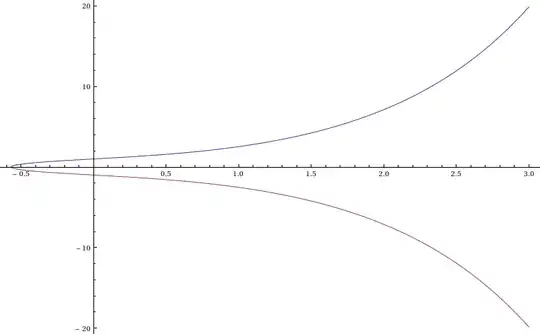

From $(2)$, we get $x^2+y^2=e^{2x}$. Therefore, the roots lie on the conjugate curves $$ y^2=e^{2x}-x^2\tag{3} $$ The roots of $z=e^z$ will lie on $(3)$ at the intersections with the curves $$ \cos(y)=xe^{-x}\tag{4} $$ Note that $(4)$ says $x\le0\implies\cos(y)\le0\implies y^2\ge\pi^2/4$. However, $e^{2x}-x^2\le1$ for $x\le0$. Therefore, all root have $x\gt0$.
