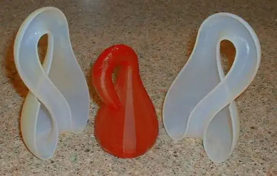

If you are careful with your deformations when you draw topological examples, you can prove it by making a very crude drawing, like the one below. The cut occurs at the vertical plane of symmetry of the bottle. It is fairly clear that the final objects are Mobius bands.
foudn here: www.ifp.illinois.edu/~sdickson/Klein/Klein.html

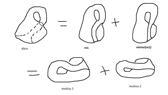

    I added a picture with the same idea where you can clearly see that the two versions are mirrored versions of each other. Source: http://www.ifp.illinois.edu/~sdickson/Klein/Klein.html – Gerard Aug 24 '14 at 14:12
    @Gerard: Ah, excellent! Thanks for the improvement. My mind didn't go to searching the net for this. –  Aug 24 '14 at 14:42

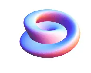

I quickly threw this animation together to demonstrate that the "figure-8" immersion of the Klein bottle admits a decomposition into two Möbius bands with the same "apparent handedness," whatever that means.
heropup
  • 143,828
  • Is it possible to change the animation into two Möbius bands with opposite "apparent handedness whatever that means"? – Gerard Aug 24 '14 at 13:46
