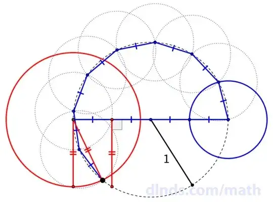

Demonstration without words (except for these):
Blue
  • 83,939
    I think I might need some words here. – Sam Yusim Aug 20 '14 at 16:36
    @SamuelYusim: The blue polygonal arc has $8$ chords of length $1/2$; the big circular arc joining its endpoints therefore has length approximately $4$. That circular arc is clearly a semicircle, plus a smaller arc that's very-nearly subtended by the red chord of length $\sqrt{3}/2$; therefore, the big arc has length also approximated by $\pi + \sqrt{3}/2$. This gives $4 \approx \pi + \sqrt{3}/2$, as desired. – Blue Aug 20 '14 at 17:49
    @SamuelYusim: Of course, the approximations are varying degrees of bad here, so the diagram hardly constitutes a rigorous numerical argument. A more-refined diagram would have blue and red chords hugging the circle more-closely. Even so, it's rather striking that the blue and red chords seem to meet so well at this very rough stage. – Blue Aug 20 '14 at 17:50
