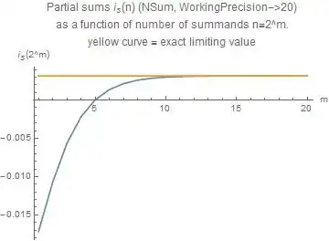

The following graph shows how the partial sums approoach the limiting value with increasing number of terms
The changing sign of the partial sums indicates that a false value $0$ can be understood on the basis of missing accuracy.
