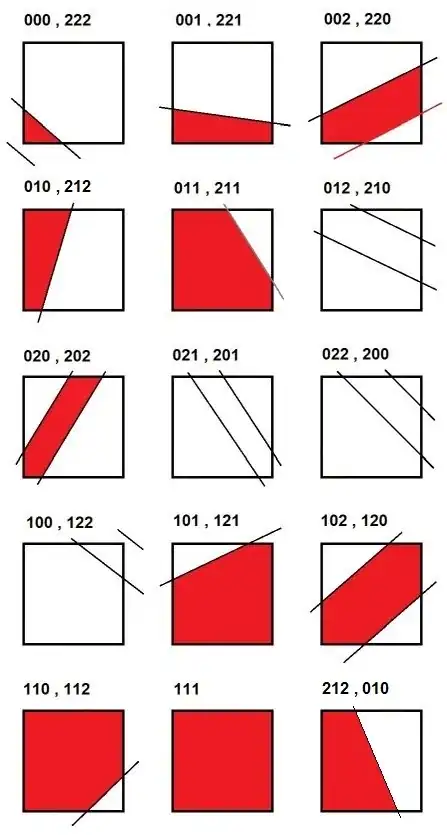

All sub cases. Consider the strip embedded inside the square, as mentioned in the question, a bit modified though (without loss of generality): $$ \left|\, \cos(\phi) x + \sin(\phi) y\, \right| < c \quad \mbox{with} \; c > 0 \; , \; 0 \le \phi < \pi \quad \mbox{for} \; 0 \le x \le 1 \; , \; 0 \le y \le 1 $$ The vertices of the square are $\;(x_k,y_k) = \left\{(0,0),(1,0),(0,1),(1,1)\right\} , \; k=0,1,2,3\;$ . Each of the vertices can be, in principle
  • $(0)$ below the strip: $\;\cos(\phi) x_k + \sin(\phi) y_k \le -c$
  • $(1)$ inside the strip: $\;-c < \cos(\phi) x_k + \sin(\phi) y_k < +c$
  • $(2)$ above the strip: $\;+c \le \cos(\phi) x_k + \sin(\phi) y_k$
With exception of $(x_0,y_0) = (0,0)$ ; this vertex is always inside the strip. (You're lucky, otherwise you had to distinguish $3^4 = 81$ cases to begin with.) Now there are $3^3 = 27$ sub cases, in principle. They can be conveniently enumerated in a base $3$ number system . For example $210$ means that vertex $(1,0)$ is below the strip, vertex $(0,1)$ is inside the strip and vertex $(1,1)$ is above the strip: the number is read from the right to the left, i.e. towards the most significant digit (as usual). Because of the restriction $0 \le \phi < \pi$ only the cases $\;000 \cdots 111\;$ have to be considered. The other cases are a mirror of these if $0 \le \phi < 2\pi$ is allowed eventually. With one noteworthy exception, though, namely $010 \not \equiv 212$ ($\color{red}{red}$) . So here comes: $$ \begin{matrix} 000 & 001 & 002 & \color{red}{010} & 011 & 012 & 020 & 021 & 022 & 100 & 101 & 102 & 110 & 111 \\ 222 & 221 & 220 & \color{red}{212} & 211 & 210 & 202 & 201 & 200 & 122 & 121 & 120 & 112 & \\ & & & & & NOP & & NOP & NOP & NOP & & & & \end{matrix} $$ A picture says more than a thousand words:
It is seen that there are at most 11 sub cases that must be taken into account.

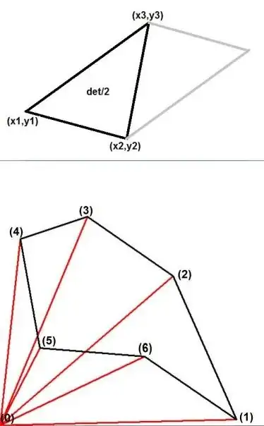

Area of polygon. Though at the moment we have only an impression of what the polygons look like, the areas of them have to be calculated, in the end. enter image description here
So it's useful anyway to have a general method for doing just that. What we can do is to draw ($\color{red}{red}$) lines from the origin $(0)$ to the vertices of the polygon (six in our case) and sum up the areas of the (six) triangles $(0,1,2),(0,2,3),(0,3,4),(0,4,5),(0,5,6),(0,6,1)$ : see figure at the bottom. The figure at the top shows how the area of just one triangle is calculated, by using a determinant: $$ \mbox{area}\,\Delta = \frac{1}{2} det\begin{bmatrix}(x_2-x_1) & (y_2-y_1)\\(x_3-x_1) & (y_3-y_1)\end{bmatrix} $$ Note that, in general, the triangle areas thus calculated can be positive as well as negative. And the latter is essential.
To be continued for the coordinates of the polygons, in anti-clockwise order.
