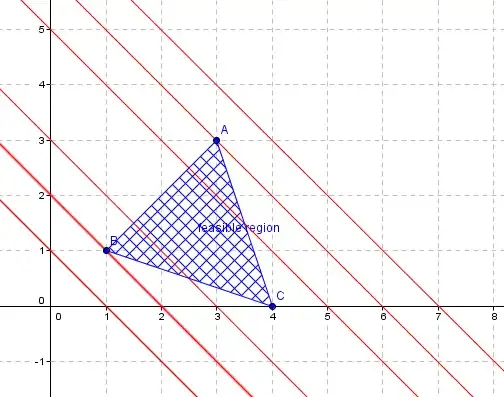

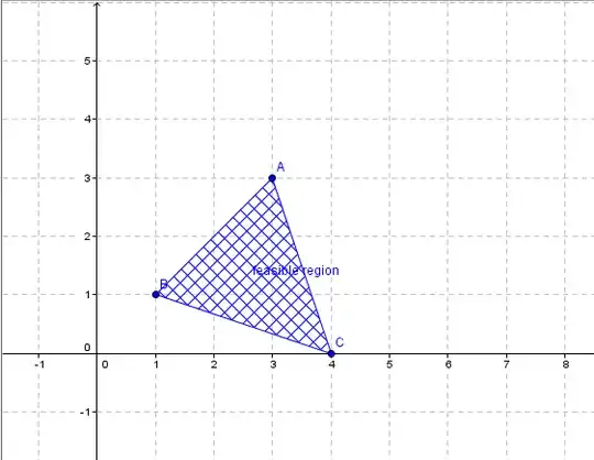

Suppose your feasible region looks as shown below :
Lets assume we're maximizing the objective function $C=ax+by$
Notice that, for different values of C, you get different straight lines of varying y intercepts but they will have same slope :
Only the lines that cut through the feasible region satisfy all the given constraints because you can cookup x,y values such that they fall in both feasible region and the objective function.
From the second picture it is obvious that the the maximum value of $ax+by=C$ occurs when the y intercept of these feasible lines is maximum. Consequently the vertex A gives the maximum value for the objective function.
AgentS
  • 12,301
    so, B is minimum? but how does someone prove that vertex will be cut by line of greatest intercept[seems correct intutively because there doesn't seem any contradiction] – RE60K Aug 13 '14 at 18:02
  • i think it is a property of convex polygons? – RE60K Aug 13 '14 at 18:04
  • BINGO! thats a good question, and yes this argument holds only when the feasible region is convex - $ax+by=C$ has y intercept of $C/b$ when $b$ is positive, the max value of $C/b$ also yields the maximum value of $C$ (just notice that y intercept is not so special, we can think around this using x intercept also) – AgentS Aug 13 '14 at 18:07
  • sorry, this could also be the accepted answer, maybe the upvote helps? – RE60K Aug 13 '14 at 18:23
    What if the edge AB of the triangle is aligned with the red lines? Every point in the edge would have the same optimal value, the answer is not clear. It would be interesting if someone could give a formal proof here. – juliohm Apr 24 '17 at 23:32
    In other words, the theorem is being incorrectly interpreted because "optimal value" is not "optimal point". The theorem only states that there exists a vertex with the optimal value, it doesn't imply that the optimal value will always happen at a vertex. The difference is subtle. If the edge AB is aligned with the red lines, then all points are optimal points, they all have the same optimal value, in particular the vertex has this value. – juliohm Apr 25 '17 at 14:43
