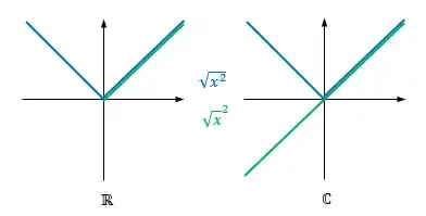

According to my logic,
$$\large\sqrt{x^2} = x^{2\times \frac{1}{2}} = x = x^{\frac{1}{2}\times 2}={(\sqrt{x})}^2$$
But when I look at the graphs of these guys, they're totally different.
Edit: Complex answers are okay, if you know what I mean.

    $\sqrt{x^2}=|x|$ and $\sqrt{x}^2=x$. – Nicky Hekster Aug 04 '14 at 15:16
    As function the first is defined on $\Bbb R$ whereas the last only on $\Bbb R_{\ge0}$. –  Aug 04 '14 at 15:17
  • @NickyHekster: How does restating the expression in a different notation clarify the meaning gap. And what if I allow these as functions to have a codomain of complex numbers? I'm merely trying to understand all this clearly. – Nick Aug 04 '14 at 15:31
    You told us that you drew a graph, so that must have been on the reals. The square root is not a well-defined function on complex numbers. Because of the fundamental theorem of algebra, you will always have two different square roots for a given number. If you want to find out the possible values, the easiest way is probably to go with De Moivre's formula. – Nicky Hekster Aug 04 '14 at 15:38
  • I am wondering what the "totally different" graphs were. – GEdgar Jun 03 '15 at 13:47

$f(x)=\sqrt{x^2}=|x|,$ so if $x\ge 0$, then $f(x)=x$. And if $x\lt 0$, then $f(x)=-x.$
On the other hand, $g(x)={\sqrt x}^2=x$ is defined only when $x\ge0.$
Hence, we know that $y=f(x)=\sqrt{x^2}$ is different from $y=g(x)={\sqrt x}^2.$

$$\sqrt{x^2} = |x|$$
And
$$\sqrt{x}^2 = x$$
But also notice that the domains are different:
$$\sqrt{x^2}: (-\infty, \infty)$$
And
$$\sqrt{x}^2 = [0, \infty)$$
Make sense now why the graphs would look different?

$\large\sqrt{x^2}$ the domain of it is $(-\infty,+\infty)$ because $x^2\ge0$ always,so $x \in $$ (-\infty,+\infty)$ and the range of the function is $[0,+\infty)$ since square root function always produces non-negative result(i.e., $\ge 0$) whereas,
${(\sqrt{x})}^2$ the domain of it is $[0,+\infty)$ since square root function accept only positive values including zero($\ge0$) and the range of it is $[0,+\infty)$ since square of any number is greater than zero($\ge0$)
