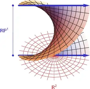

$\mathbb{RP}^1$ can be thought of as the line segment $[0,\pi]$ with its endpoints identified, so:
  • Thanks for the picture! Inspires me to think of the blow up of the plane as some kind of mobile, hanging in the air. OK... – Amitai Yuval Aug 03 '14 at 22:57
