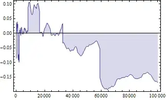

Out of interest I include the difference up to $10^5$ between the RHS and the LHS

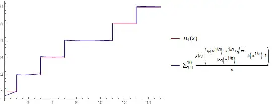

and both together for very small $x$
