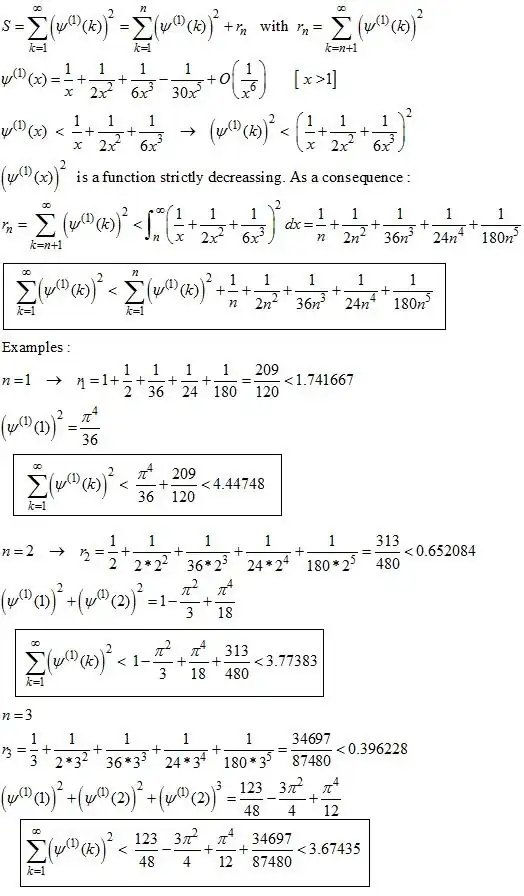

Applying the Copson's inequality, I found: $$S=\displaystyle\sum_{k=1}^{\infty }\left(\Psi^{(1)}(k)\right)^2\lt\dfrac{2}{3}\pi^2$$ where $\Psi^{(1)}(k)$ is the polygamma function. Is it known any sharper bound for the sum $S$? Thanks.

You may evaluate your series in closed form.
Here are the steps.
Recall the following standard representation for the digamma function: $$ \psi(x) = -\gamma+\int_0^1 \frac{1 - t^{x-1}}{1 - t}{\rm{d}} x, \quad x>0, $$ giving, by differentiation, $$ \psi'(x) = -\int_0^1 \frac{t^{x-1} \ln t}{1 - t}{\rm{d}} x, \quad x>0. $$ One may deduce $$ \left(\psi'(k)\right)^2 = \int_0^1\int_0^1 \frac{(uv)^{k-1} \ln u\ln v}{(1 - u)(1-v)}{\rm{d}}u \:{\rm{d}} v $$ and $$ \sum_{k=1}^\infty\left(\psi'(k)\right)^2 = \int_0^1 \! \!\int_0^1 \frac{\ln u\ln v}{(1-uv)(1 - u)(1-v)}{\rm{d}} u\:{\rm{d}} v $$ By partial fraction decomposition and successive integrations involving $\text{Li}_{2}(\cdot)$, you arrive at $$ \sum_{k=1}^\infty\left(\psi'(k)\right)^2 = 3\zeta(3) = 3.60617070947878285619921 \cdots. $$

Continuing from Olivier Oloa's answer,
$$ \begin{align} \sum_{k=1}^{\infty} \big(\psi^{(1)} (k) \big)^{2} &= \int_{0}^{1} \int_{0}^{1} \frac{\ln u \ln v}{(1-uv)(1-u)(1-v)} \ du \ dv \\ &= \int_{0}^{1} \frac{\ln v}{(1-v)^{2}} \int_{0}^{1} \left(\frac{\ln u}{1-u} - \frac{v \ln u}{1-vu} \right) \ du \ dv \\ &= \int_{0}^{1} \frac{\ln v}{(1-v)^{2}} \left( \int_{0}^{1} \frac{\ln u}{1-u} \ du - v \int_{0}^{1} \frac{\ln u}{1-vu} \ du\right) \ dv \end{align}$$
where $$ \int_{0}^{1} \frac{\ln u}{1-u} \ du = \int_{0}^{1} \frac{\ln (1-w)}{w} = -\text{Li}_{2}(1) = -\zeta(2) $$
and
$$ \int_{0}^{1} \frac{\ln u}{1-vu} \ du = - \frac{1}{v} \ln(1-vu) \ln u \Bigg|^{1}_{0} + \frac{1}{v} \int_{0}^{1} \frac{\ln (1-vu)}{u} \ du = - \frac{\text{Li}_{2}(v)}{v} .$$
Therefore,
$$ \sum_{k=1}^{\infty} \big(\psi^{(1)} (k) \big)^{2} = \int_{0}^{1} \frac{\ln v}{(1-v)^2} \Big(\text{Li}_{2}(v) - \zeta(2) \Big) \ dv .$$
Then integrating by parts,
$$ \begin{align} &= \big(\text{Li}_{2}(v) - \zeta(2) \big) \left(\ln (1-v) + \frac{v \ln v}{1-v} \right)\Bigg|^{1}_{0} + \int_{0}^{1} \frac{\ln^{2}(1-v)}{v} \ dv + \int_{0}^{1} \frac{\ln(1-v) \ln v}{1-v} \ dv \\ &= \int_{0}^{1} \frac{\ln^{2}(1-v)}{v} \ dv + \int_{0}^{1} \frac{ \ln(1-v) \ln v}{1-v} \ dv \end{align}$$
where $$ \begin{align} \int_{0}^{1} \frac{\ln^{2}(1-v)}{v} \ dt &= \ln^{2}(1-v)\ln v \Bigg|^{1}_{0} + 2 \int_{0}^{1} \frac{\ln(1-v) \ln v}{1-v} \ dv \\ &= 2 \int_{0}^{1} \frac{ \ln(1-v) \ln v}{1-v} \ dv . \end{align} $$
Therefore, $$ \begin{align} \sum_{k=1}^{\infty} \big(\psi^{(1)} (k) \big)^{2} &= 3 \int_{0}^{1} \frac{\ln(1-v) \ln v}{1-v} \ dv \\ &= -3 \int_{0}^{1} \ln v \sum_{n=1}^{\infty} H_{n}v^{n} \ dv \\ & = -3 \sum_{n=1}^{\infty} H_{n} \int_{0}^{1} v^{n} \ln v \ dv \\ &= 3 \sum_{n=1}^{\infty} \frac{H_{n}}{(n+1)^{2}} \\ &= 3 \left(\sum_{n=1}^{\infty} \frac{H_{n+1}}{(n+1)^{2}} - \sum_{n=1}^{\infty} \frac{1}{(n+1)^{3}} \right) \\ &= 3 \left( \sum_{n=1}^{\infty} \frac{H_{n}}{n^{2}} -1 - \zeta(3) + 1 \right) \\ &= 3 \big(2 \zeta(3) - \zeta(3) \big) \tag{1} \\ &= 3 \zeta(3) .\end{align} $$
