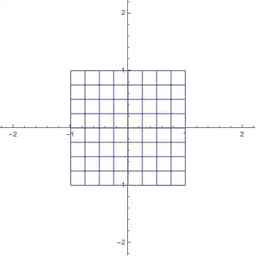

But here's what a naive linear interpolation ($z \to (1-t) z + t f(z)$, with $0 \leq t \leq 1$) of the same transformation $z \to \frac{1}{z}$ looks like:
inversion with linear interpolation
As you can see, this method creates a lot of "kinks" and weird bends along the way. (Also, ignore the straight lines). I'm trying to avoid this, as it makes the animation more confusing than it should be.
Some other examples. Here's the same method for $z \to z^2$:
z to z^2

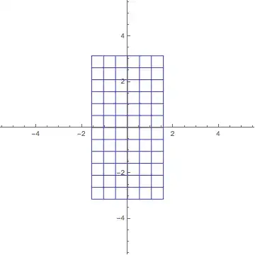

EDIT: Here's $z \to e^z$ using Rahul's method with some translation:
z to exp(z)
This is pretty much a perfect example of the sort of "natural" transformation I'm looking for. Each new step seems like an obvious deformation of the previous step following the same overall "style". It creates a nice sense of deliberation, which makes the movement intuitive, comprehensible and predictable.

Suppose $f$ is such that $f(0)=0$ and $f'(0)=1$. Then we can define $$f_t(z) = \begin{cases} z & \text{if $t = 0$,} \\ \frac1tf(tz) & \text{otherwise.} \end{cases}$$ One can verify that $\lim\limits_{t\to0}f_t={\rm id}$ and $f_1=f$, so $f_t$ interpolates between ${\rm id}$ and $f$. Furthermore, if $f$ is an analytic (or polynomial, or rational, etc.) function, then so is $f_t$.
For example, when $f(z)=e^z-1$, then $f_t(z)$ is also exponential:
If $f$ does not satisfy the conditions $f(0)=0$ and $f'(0)=1$, we will transform it so that it does. Pick a point $z_0$ such that $f'(z_0)\ne 0$. Let $w_0=f(z_0)$ and $a=f'(z_0)$. Define a pair of rigid transformations $$\begin{align} u=\phi_0(z) &= a^{1/2}(z-z_0), \\ v=\phi_1(w) &= a^{-1/2}(w-w_0), \\ \end{align}$$ and define $g$ so that this diagram commutes: $$\require{AMScd} \begin{CD} z @>{\phi_0}>> u \\ @V{f}VV @VV{g}V \\ w @>>{\phi_1}> v \end{CD}$$ One can verify that $g(0)=0$ and $g'(0)=1$. Thus, $g$ satisfies the conditions for interpolation as above. We can also construct a family of rigid transformations interpolating between $\phi_0$ and $\phi_1$, for example via $$\phi_t = a^{1/2-t}(\cdot-(1-t)z_0-tw_0).$$ Then we can interpolate $f$ by "slicing" the diagram a part of the way down, giving $$f_t = \phi_t^{-1}\circ g_t\circ\phi_0.$$
Here are some more examples.
$f(z)=1/z$ and $z_0=-i$:
$f(z)=e^z$ with $z_0=0$:
Sometimes it helps to insert other transformations before doing the interpolation. For example, $$\require{AMScd} \begin{CD} z @>{\log}>> @>{\phi_0}>> u \\ @V{f}VV @. @VV{g}V \\ w @>>{\log}> @>>{\phi_1}> v \end{CD}$$
$f(z)=z^2$ with $z_0=\log 1$ (this reduces to $f_t(z)=z^{2^t}$, not too far from the obvious $z^{1+t}$):

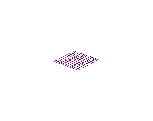

I have also made some graphics like this where I needed some kind of interpolation. I often ended up trying to find a general formula that includes the initial case as well as the target as special cases where each just some parameters have to be changed. For example for the function $z \mapsto z^2$ The more general function would be $f_c(z) = z^c$ and for the interpolation I'd just try to 'slide' c from $1$ to $2$.
In the following example lets have a look at a moebius transformation $z \mapsto \frac{z}{2z+3}$ Here you have multiple choices of doing the transition. Now you can for example take $f_{a,b,c}(z) = \frac{z}{(az+b)^c}$ Here we can for example 'slide' $c$ from $0$ to $1$ with $a=2, b=3$ or slide simultaneausly $a$ from $0$ to $2$ and $b$ from $1$ to $3$ or combine both with the sliding of $c$.
For the example $z \mapsto e^z$ such a 'more general funciton' might look like this $z \mapsto az+be^z$ (which results in linear interpolation with the suggested method) but you can also try $z \mapsto z^a+e^{zb} -1$ etc.
It often takes some trial and error to find a 'the right way' but this seems to work for many examples. I often use then an additional variable $t$ that definides the sliding with $t=0$ for the initial state and $t=1$ for the target state and $t\in(0,1)$ for everything between, so then the function looks like this:
$$F_t(z) = f_{2t,2t+1,t}(z)$$
The use of this variable makes it easier to modify again the sliding action by replacing t by different functions that map $[0,1]$ to $[0,1]$ continuously with $0 \mapsto 0$ and $1 \mapsto 1$. You can easily make a list of different functions like this which you can try for then optimizing the transitions. E.g. $t \mapsto sin(t\pi)^c$,$t \mapsto t^c$,$t \mapsto -2t^3+3t^2$ and so on.
EDIT: We found still no satisfying solution, here the graphics of $z \mapsto \frac 1 z$ relating to the problem mentioned in the comments. z to 1/z mapping in 3d

  • What I was hoping for, I suppose, is some way to use the derivatives of the functions in some way, to figure out how to make the transitions naturally. If an intermediate step in the interpolation creates kinks, then the derivative will behave badly at those points and maybe knowing this would help me find a way to avoid the problem in general. The derivatives will tell how the map is curved, and this information seems useful in this case. I'm just not sure how to use it. – LucasVB Jul 28 '14 at 16:16
  • Now that you mention the derivatives I just thought perhaps you can use the taylor series approximations of that function for interpolation, but I am not sure how well they 'behave' when using complex numbers, up to now I only worked with them for $\mathbb R^n \to \mathbb R$ functions. But I really thinkt it is impossible to smoothly interpolate $z \to \frac 1 z$ because you'd turn 'the inside out' which will as far as i know never generate really nice images. – flawr Jul 29 '14 at 08:06
  • Have you checked the video on Möbius transformations I mentioned? It does inversion beautifully. I'll experiment with Taylor approximations. Thanks! – LucasVB Jul 29 '14 at 09:23
  • Yes I did now watching again I thought that this was basically a stereographic projection, but I didn't yet figure out how to phrase that as a möbius transformation. – flawr Jul 29 '14 at 12:55
    I think this paper might help: http://www.ima.umn.edu/~arnold//papers/moebius.pdf One of the parameters listed in page 4 could be that rotation of the Rieman Sphere that makes up $z \mapsto \frac 1 z$ – flawr Jul 29 '14 at 13:21
  • Wonderful 3D animations! Where's the $z$ axis coordinate coming from? – LucasVB Jul 30 '14 at 01:23
  • The amount of deviation from $0$ from $c \in \mathbb C$ is $Im(c)^2$ (squared distance to the line $Im(c) = 0$), because the movement is symmetrical along $Im(c) = 0$ The sign of the the $z$-Value is basically the $sgn(Im(c))$. The whole value is multiplied by $t(1-t)$ for the interpolation $0\leq t \leq 1$, so it's $z=t(1-t)Im(c)|Im(c)|$. The $x$ and $y$ values are just linear interpolations of $z\mapsto \frac 1 z$ =) – flawr Jul 30 '14 at 08:26
