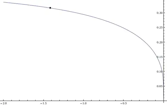

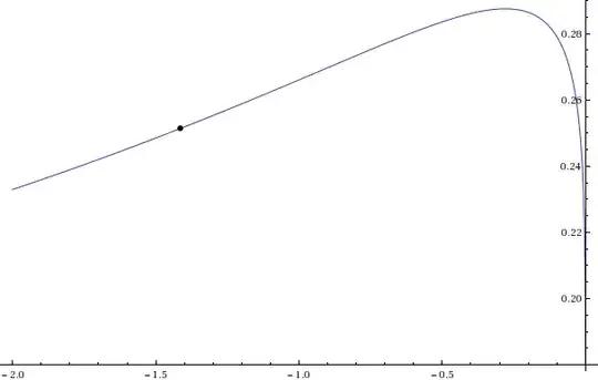

Looks like $-\sqrt{2}$ isn't a solution for the equation, but I'm not sure. Looks like too, the power tower of a number should converge only on a specific interval ($[e^{−e},e^{1/e}]$).
But using Mathematica and the ProductLog function (wich the Lambert $W(z)$ function) we find some strange things:
Using $h(z)=z^{z^{z^{\ldots}}}=-\frac{W(-\log (z))}{\log (z)}$ (h[z_]:=(-ProductLog[-Log[z]])/Log[z])
Calculating the power tower to $\sqrt{2}$ we have N[h[Sqrt[2]], 10]=2.000000000
And the power tower to $-\sqrt{2}$ we have N[h[-Sqrt[2]], 10]=0.2513502988 + 0.3162499180 I
Calculating explicity, by iteration
${-\sqrt{2}},{(-\sqrt{2})}^{({-\sqrt{2}})},{(-\sqrt{2})}^{({-\sqrt{2})}^{\ldots}}$ we have
Table[N[Re[PowerTower[-Sqrt[2], i]], 30] + I*N[Im[PowerTower[-Sqrt[2], i]], 5], {i, 1, 15}] // TableForm
-1.41421356237309504880168872421

Ploting the real and imaginary part of the function $h$, we have:
To the real part:
Plot[Re[N[h[x]], {x, -2, 0}, Epilog -> {PointSize[0.01], Point[{-Sqrt[2], N[Re[h[-Sqrt[2]]]]}]}]
Real part of the tower of -Sqrt[2]
and to the imaginary part:
Plot[Im[N[h[x]], {x, -2, 0}, Epilog -> {PointSize[0.01], Point[{-Sqrt[2], N[Im[h[-Sqrt[2]]]]}]}]
Imaginary part of the tower of -Sqrt[2]
So looks like the function converges, but, unfortunally not to $2$.
