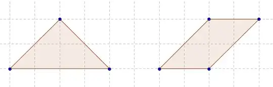

The simplest example is an isosceles triangle and a parallelogram:
cut and flip triangle parallelogram

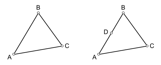

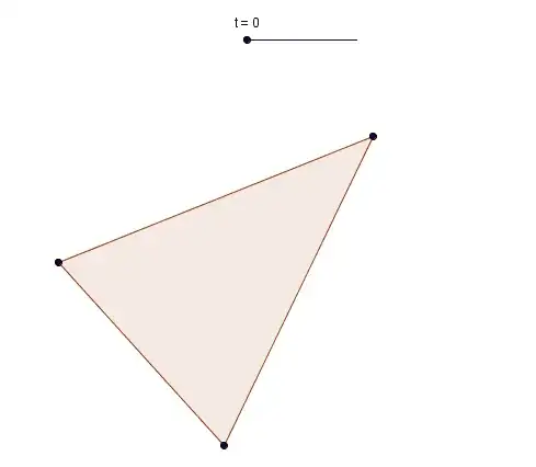

However you can start with any triangle and progressively make shapes with more and more sides:
cut and flip animation

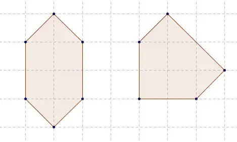

You can make a hexagon and a pentagon with the same area and perimeter by gluing triangles to a square:
hexagon and pentagon with same area and perimeter
The area of both is $6$ units$^2$ and the perimeter of both is $4 + 4\sqrt2$ units. It's particularly pleasant that both shapes are convex.
(Note also that these two are related by a "cut and flip" as described in my other answer.)
