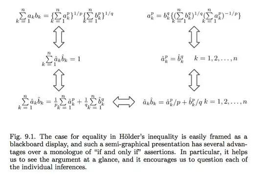

A very nice “blackboard summary” of the equality case (for finite sequences) is given in Steele's excellent book The Cauchy–Schwarz Master Class. Let $a = (a_1,\ldots,a_n) \geq 0$ and $b = (b_1, \ldots, b_n) \geq 0$ and let $\hat{a}_i = \dfrac{a_i}{\|a\|_p}$ and $\hat{b}_i = \dfrac{b_i}{\|b\|_q}$. Then your argument is subsumed by the diagram (with an unfortunate typo in the upper right corner—no $p$th and $q$th roots there):
Steele's diagram for Hölder equality
Mimicking this for functions, let us write $\hat{f} = \dfrac{|f|}{\|f\|_p}$ and $\hat{g} = \dfrac{|g|}{\|g\|_q}$ (assuming of course $\|f\|_p \neq 0 \neq \|g\|_q$), so $\int \hat{f}\vphantom{f}^p = 1$ and $\int \hat{g}^q =1$ and thus your argument becomes $$ \begin{array}{ccc} \int |fg| = \left(\int|f|^p\right)^{1/p} \left(\int|g|^q\right)^{1/q} & & |f|^p = |g|^q \frac{\|f\|_{p}^p}{\|g\|_{q}^q} \text{ a.e.}\\ \Updownarrow\vphantom{\int_{a}^b} & & \Updownarrow \\ \int \hat{f}\,\hat{g} = 1 & & \hat{f}\vphantom{f}^p = \hat{g}^q \text{ a.e.} \\ \Updownarrow\vphantom{\int_{a}^b} & & \Updownarrow \\ \int \hat{f}\,\hat{g} = \frac{1}{p} \int \hat{f}\vphantom{f}^p + \frac{1}{q} \int \hat{g}^q & \qquad \iff \qquad & \hat{f}\,\hat{g} = \frac{1}{p} \hat{f}\vphantom{f}^p + \frac{1}{q} \hat{g}^q \text{ a.e.} \end{array} $$
