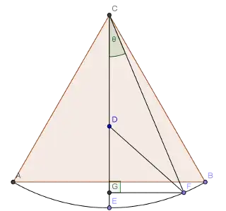

I'll provide a solution for the triangle. It is easily generalizable to other Reuleaux polygons. From this javascript demo and this webpage, we see that a road amenable to Reuleaux wheels consists of a series of bumps. Our goal here is to provide a formula for one of those bumps.
Reuleaux diagram
Let $ABC$ be an equilateral triangle of side length 1. Let $D$ be the centroid of $ABC$. Let $AEFB$ be a circular arc centered on $C$ and passing through $A$ and $B$, where $CE$ is chosen to bisect $AB$ and $F$ is an arbitrarily chosen point on the arc. Finally, let $G$ be a point on $CE$ so that $FG$ is perpendicular to $CE$.
The idea is to measure the length $\overline{DF}$ as a function of $\theta = \angle FCE$. We proceed as follows:
  1. $\overline{CD} = {1\over{\sqrt{3}}}$ (exercise left to the reader)
  2. $\overline{CF} = 1$ (by definition)
  3. $\overline{FG} = \sin(\theta)$
  4. $\overline{CG} = \cos(\theta)$
  5. $\overline{DG} = \overline{CG} - \overline{CD} = \cos(\theta) - {1\over{\sqrt{3}}}$
  6. $\overline{DF} = \sqrt{\sin(\theta)^2 + \cos(\theta)^2 - {2\over{\sqrt{3}}}\cos(\theta) + {1\over 3}}$
  7. $\overline{DF} = \sqrt{{4\over 3} - {2\over{\sqrt{3}}}\cos(\theta)}$

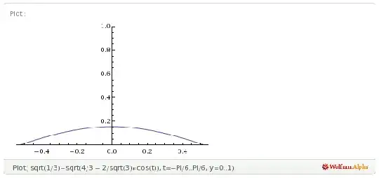

We observe that $\overline{DF}$ is maximized when $\theta$ is greatest; in this case, when $\theta = {\pi \over 6}$, where $\overline{DF} = \sqrt{1 \over 3}$. From this, we conclude that we can model one of the Reuleaux road bumps by:$$\sqrt{1 \over 3} - \sqrt{{4\over 3} - {2\over{\sqrt{3}}}\cos(\theta)}\quad,\qquad {-\pi \over 6} \leq \theta \leq {\pi \over 6}$$
We can go to Wolfram Alpha for a plot of this curve:
Wolfram plot
