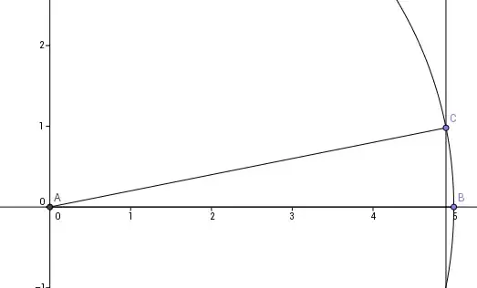

Just draw the diagram!
What does $\sin x$ mean? it's the ratio of the opposite side to the hypotenuse in a triangle.
Now, let's draw a triangle with a small angle $x$ inside the unit circle:
$\quad\quad\quad$enter image description here
Now clearly, when the angle becomes really small, the opposite side is approximately the arc length. In radians, the arc length in a unit circle is exactly the angle $x$, and so we have for small angles:
$$\sin x = \frac{\text{opposite}}{\text{hypot}} = \frac{\text{opposite}}{1}\approx \frac{x}{1} = x$$
    Thanks perfectly explained :) – Nafiul Islam Jul 17 '14 at 17:31
  • 25
    This is really a bad explanation, because it is misleading and ends up not justifying precisely what is in question. It is easy to draw diagrams that "clearly" show all sorts of false relationships. See here, for instance. – Andrés E. Caicedo Jul 17 '14 at 17:44
  • 11
    @AndresCaicedo - you are of course correct. This wasn't meant as a "proof", but rather as a good way to gain intuition. – Nathaniel Bubis Jul 17 '14 at 17:50
    You can make this proof more rigorous by considering areas instead of arclengths. Specifically, the area of sector $BAC$ is $\frac{1}{2}\theta$ while the area of triangle $BAC$ is $\frac{1}{2}\sin \theta$. – JimmyK4542 Jul 17 '14 at 19:42
  • Doesn't this assume the question really means $\sin(\phi) d\phi \thickapprox d\phi$? – jpmc26 Jul 18 '14 at 02:12
  • @nbubis with no intuition for why this intuition is more valid than wrong intuition. That's Andres' point. – djechlin Jul 18 '14 at 03:04
    @GamesBrainiac also, if you look at the graph of the $sine$ function, you will see that $x$ and $\sin(x)$ intersect at $0$. And, at values very near to $0$, they are very close to each other... – user3459110 Jul 18 '14 at 04:17
    I like this answer because it also tells us that $\cos x\approx1$ for small values of $x$. – user1729 Jul 18 '14 at 08:24
  • To extend things a little further, draw a line segment which is tangent to the circle and leaves going "counter-clockwise", with the same length as AC. Since that line is tangent to the circle, its slope will match that of the circle at C. Translate that line segment so that the endpoint that was at C is now at A, and the other endpoint will be on the circle, 90 degrees counterclockwise from the original. – supercat Jul 18 '14 at 20:20
    @AndresCaicedo: Thanks for that link showing $\pi =4$. It goes on to show that the concept of area is much more intuitive and easier to handle than that of length. Therefore if one is defining trig functions through a circle then it is better to use the concept of area for measuring the angle. – Paramanand Singh Jul 20 '14 at 05:16
  • I have a proof similar to the one required in this answer http://math.stackexchange.com/questions/605915/find-the-limit-displaystyle-lim-x-to-0-sin-x-frac1-ln-x/775759#775759 – John Joy Aug 12 '14 at 12:45

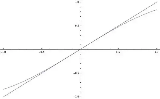

29
You can give a linear approximation for $\sin$ near $0$ based on this formula: $$f(x)\approx f(x_0)+(x-x_0)f'(x_0),$$ and using the fact that: $\sin^\prime=\cos$, you get: $$\eqalign{\sin x&\approx \sin0+(x-0)\cos(0)= x.}$$ So when $x$ is very small, you have that $\sin x\sim x.$
What this intuitively means, is that when you observe closely the graph of the curve $\color{darkmagenta}{\sin x}$ near $0$, it starts to resemble a line, and this line is described by $y=\color{darkblue}x$.
$\phantom{XXX}$cc-1
Hakim
  • 10,311
  • Can you perhaps give a reference/name for your formula? – user1729 Jul 18 '14 at 08:22
    @user1729: that's just the first-order Taylor expansion, with the remainder "hidden" in the $\approx$ symbol. A slightly more rigorous form would be $f(x) = f(x_0) + (x-x_0) f'(x_0) + o(x-x_0)$ (using the Peano form for the remainder). – Matteo Italia Jul 18 '14 at 10:12
  • @user1729 It is also known as Newton's approximation (because from it one can easily derive Newton's method although it is misnamed since it's Raphson's version of the method, rather than Newton's, that is to be found in most textbooks.) – Hakim Jul 28 '14 at 00:57
