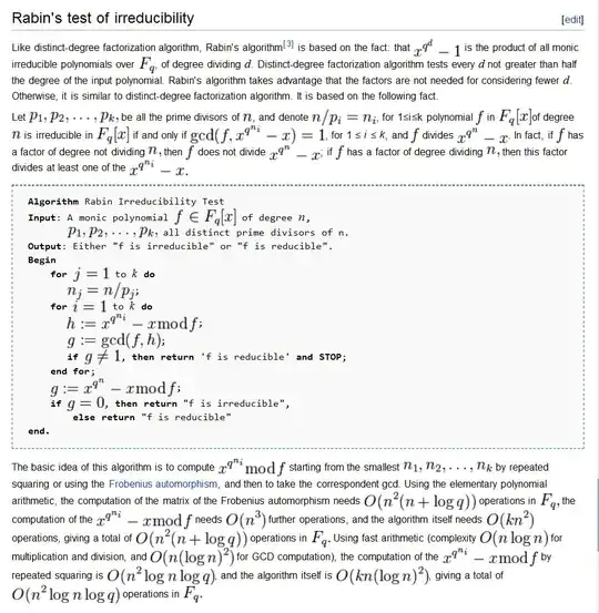

Yes, over finite fields there is a polynomial irreducibility test that is an an efficient analog of the impractical Pocklington-Lehmer integer primality test (see also Section 3.4.3 and Section 8.3.1 of Henri Cohen's book A Course in Computational Algebraic Number Theory). Below is a description of one form of this algorithm, from this Wikipedia page.
Bill Dubuque
  • 282,220
  • Do I read correctly that this is based upon a necessary and sufficient condition for irreducibility (unlike Fermat's primality test)? Very nice, thank you for sharing! – Manny Reyes Jul 01 '14 at 21:00
  • @Manny Yes, for both the polynomial and integer tests. The classical proofs are quite elementary, e.g. see Cohen's book (the links are to the exact pages). – Bill Dubuque Jul 01 '14 at 21:21
