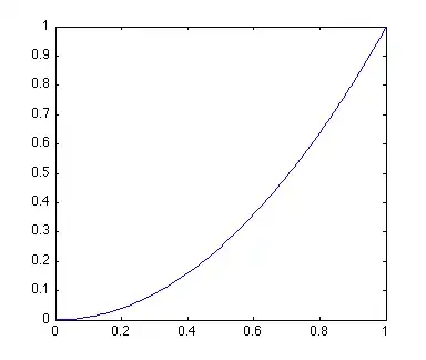

For example, in Matlab we might do this to get the curve we're trying to integrate:
>> x = 0:0.01:1;          % Creates a list [0, 0.01, ... 0.99, 1]
>> plot(x,x.^2)
which gives the following plot:
quadratic

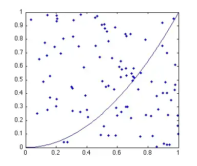

We then need to generate some random points to scatter throughout the plot:
>> N = 100;
>> xpts = rand(N,1);
>> ypts = rand(N,1);
>> hold on                    % Plot over the top of our last plot
>> plot(xpts,ypts,'.')
points

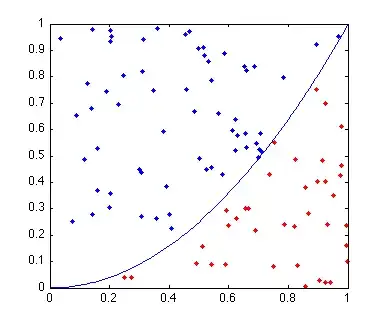

Now you need to know which of the points fall under the curve (and let's plot them too, for fun)
>> under = ypts < xpts.^2;
>> plot(xpts(under),ypts(under),'r.')
pointsred
The vector under is now a vector of 1s wherever the point (x,y) is under the curve and 0s when it is above the curve. To approximate the area under the curve we find the average of this vector (with the mean function) and multiply it by the area of the rectangle (which is 1 in this case, but might not be in general).
>> area = 1 * mean(under);
>> disp(area)
0.3800
We know that the exact area is 1/3, so this isn't too bad an approximation.

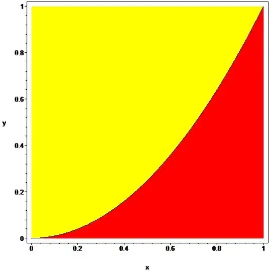

Your integral is the area $A$ under the graph of $y = x^2$ and above $y=0$ for $x$ from $0$ to $1$:
The total area of the square $0 \le x \le 1$, $0 \le y \le 1$ is $1$. If you choose a random point $(X,Y)$ in this square, the probability that this point will be in the red region will be the fraction of the area of the square that is red, namely $A$. Now imagine choosing $n$ random points $(X_j, Y_j)$, independently, in this square. Each has probability $A$ of being in the red region, so if $n$ is large the number $R$ of points in the red region will probably be close to $n A$. Therefore we can use $R/n$, the fraction of our points that fall in the red region, as an estimate for $A$.

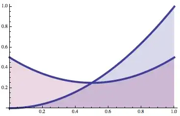

    both are 'smooth' functions. Can you elaborate on the rationale for doing this? – Memming Feb 01 '14 at 16:58
  • @Memming What I mean is 'closer to a constant function'. This is a usual trick in Montecarlo integration: We try to integrate something which does not change abruptly. Maybe, 'smooth' was not a clear word. English is not my native language. Sorry. – Felix Marin Feb 01 '14 at 18:43
  • This transformation gives better convergence properties for the algorithm described in your code (which is essentially Gaussian quadrature at random locations) but that's not what I understand by the "hit and miss" method (generating random $(x,y)$ pairs and checking to see if they fall into the region being integrated). – Chris Taylor Feb 01 '14 at 19:12
  • @ChrisTaylor I agree. They are different but it serves for the same purpose. Thanks. – Felix Marin Feb 01 '14 at 19:27
