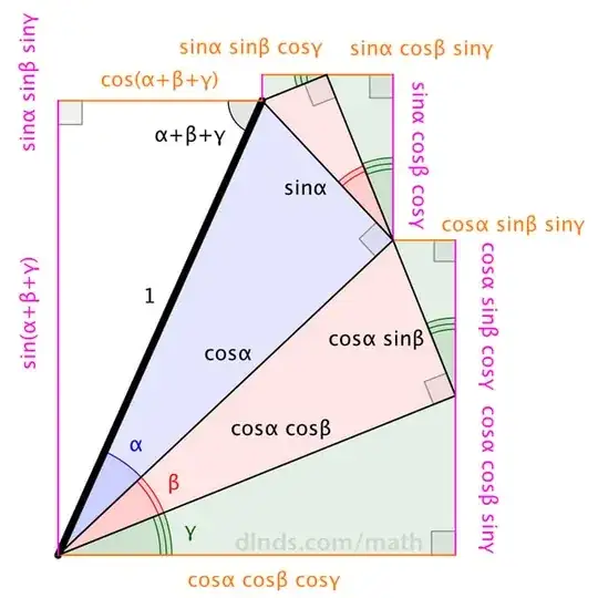

Enhancing my diagram for the angle-sum formula (currently featured in Wikipedia) to use three angles will get you pretty close ...
Thus,
$$\begin{align} \cos(\alpha+\beta+\gamma) &= \cos\alpha \cos\beta \cos\gamma - \sin\alpha \sin\beta \cos\gamma - \sin\alpha \cos\beta\sin\gamma - \cos\alpha \sin\beta\sin\gamma \\ \sin(\alpha+\beta+\gamma) &= \sin\alpha \cos\beta \cos\gamma + \cos\alpha \sin\beta \cos\gamma + \cos\alpha \cos\beta \sin\gamma - \sin\alpha \sin\beta \sin\gamma \end{align}$$
With $\alpha = \beta = \gamma = \theta$, these become ... $$\begin{align} \cos 3\theta &= \cos^3\theta - 3 \sin^2\theta \cos\theta \\ \sin 3\theta &= 3\cos^2\theta \sin\theta - \sin^3\theta \end{align}$$ ... which the Pythagorean identity helps us rewrite as ... $$\begin{align} \cos 3\theta &= \cos^3\theta - 3 (1-\cos^2\theta) \cos\theta = 4\cos^3\theta - 3 \cos\theta \\ \sin 3\theta &= 3(1-\sin^2\theta) \sin\theta - \sin^3\theta = 3\sin\theta - 4\sin^3\theta \end{align}$$
Off-hand, I don't know of a diagram that goes directly from $\cos 3\theta$ to $4\cos^3\theta-3\cos\theta$.

    That is absolutely amazing. – bobby Jun 30 '14 at 13:29
    I just love it when someone has the time and effort to make a truly helpful and fascinating visual explanation. Sometimes when the numbers and letters just swim around, a picture can be very helpful – Asimov Sep 04 '14 at 14:17
  • How do you get something featured on Wikipedia? Do you submit it somewhere and then wait for someone to place it on an article? – étale-cohomology Aug 09 '17 at 22:31
    @étale-cohomology: The "wiki" in "Wikipedia" indicates that the content is user-editable. Anybody can go in and make improvements. As for my diagrams: I'd posted them here, and then someone posted "similar" versions to Wikipedia (without credit or notice); someone from here at Math.SE edited the post so that I'd get credit. (Thanks again @ChrisSherlock!) I, myself, recently went in and edited the article's description of those diagrams and provided a link to my new website for such things in the article's list of references. – Blue Aug 09 '17 at 23:00

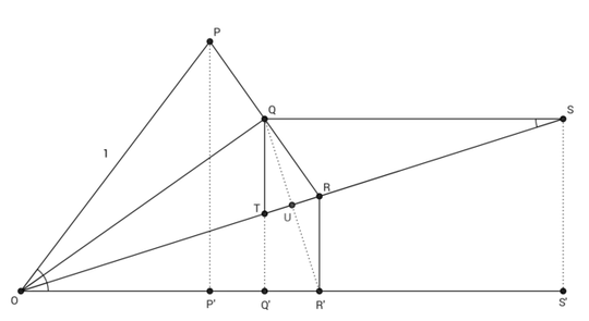

Assemble four congruent right triangles with hypotenuse $1$ and angle $\theta$ as shown:
Diagram
In the diagram, the marked angles are all $\theta$. Since $OQ = \cos\theta$, we have $OU = \cos^2\theta$, so $OS = 2\cos^2\theta$, and so $$ OS' = 2\cos^3\theta $$ On the other hand, $$ OS' = OP' + P'Q' + Q'S' = \cos(3\theta) + P'Q' + \cos(\theta) $$ and $$ OS' = OR' - Q'R' + Q'S' = \cos(\theta) - Q'R' + \cos(\theta) $$ Since $P'Q' = Q'R'$, adding these together yields $$ \cos(3\theta) + 3\cos(\theta) = 2OS' = 4\cos^3\theta $$
I hope the diagram is reasonably self-explanatory, that it's clear what needs to be proved to justify the steps of the argument, and that it's easy to prove those things once you've identified them. But if I've misjudged this, let me know and I'll fill in some more details.

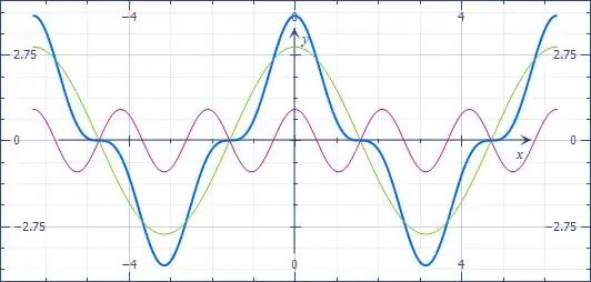

This is not a direct proof but a link to the Fourier series: $4\cos^3\theta=3\cos\theta+\cos3\theta$.
Similarly, for the fifth power: $16\cos^5\theta=10\cos\theta+5\cos3\theta+\cos5\theta$.
The main lesson is that to represent the $k^{th}$ power, the odd harmonics from $1$ to $k$ suffice.
The explanation is not so difficult: the Fourier coefficients are computed from the integrals $$\int_0^{2\pi}\cos^k\theta\ e^{in\theta}d\theta=\int_0^{2\pi}\left(\frac{e^{i\theta}-e^{-i\theta}}2\right)^ke^{in\theta}d\theta.$$ When developing, the lowest exponent of $e^{i\theta}$ is $n-k$. If $n>k$, the integrand is oscillatory and the integral vanishes.
If you admit that, then $\cos^3\theta=a\cos\theta+b\cos3\theta$.
From the figure, at $\theta=0$ the values add up to $1$ and at $\theta=\pi/2$ the slopes cancel out, so that $$a+b=1\\a-3b=0,$$ $$\cos^3\theta=\frac34\cos\theta+\frac14\cos3\theta.$$

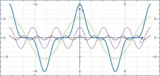

Similarly, $\cos^5\theta=a\cos\theta+b\cos3\theta+c\cos5\theta$, at $\theta=0$ the values add up to $1$ and at $\theta=\pi/2$ the first and third derivatives cancel out, so that $$a+b+c=1\\ a-3b+5c=0\\ a-27b+125c=0,$$ $$\cos^5\theta=\frac{10}{16}\cos\theta+\frac{5}{16}\cos3\theta+\frac{1}{16}\cos5\theta.$$
