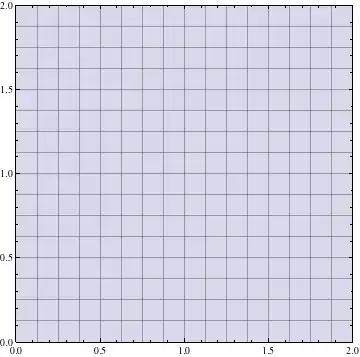

Here is something: Iterating
$$f_0(x):=0, \quad f_{n+1}(x):= x^2-f_n\bigl(f_n(x)\bigr)$$
one obtains a sequence of polynomials whose lowest terms stabilize at
$$x^2-x^4+2x^6-4x^8+8x^{10}-16 x^{12}+32 x^{14}-65 x^{16}+\ldots-17316 x^{28} +\ldots\ .$$
The sequence of coefficients so obtained (apart from the sign) is listed here: OEIS, but I can't make anything out of the explanation given there.
    That seems to work for $|x|<0.57$ or so, but looks as if will not converge for large $x$. – Henry Nov 24 '11 at 12:43
  • Could this series expansion be extended somehow? (I don't know enough math do to it.) – Eric Yu Nov 24 '11 at 20:22
  • My guess would be that the higher order coefficients will diverge from both of those. The second one, if you solve the series reversion, will get you a functional equation reminiscent, but likely not the same, as the one that is given in the original post. In the notation of OEIS, your power series should solve A(x) = Series_reversion{ Sqrt[ x + A(x) ] }, I think. – Willie Wong Nov 25 '11 at 09:41
EDIT: the first couple of times I tried to post this answer, it refused. It turns out there is a 30,000 character maximum for answers, probably for questions. So I cut the table down, previously it was $ 5 \geq x \geq -1.$
ORIGINAL: Well, this was fun. I am not sure how to do your actual problem, So, instead, I solved the easier $$ f(f(x)) = x + x^2,$$ by a little-known procedure due to J. Ecalle, about 1973. The method is described in a book by M. Kuczma, B. Chococzewski, R. Ger, called Iterative Functional Equations. I give the value of $f(x)$ for $ 3 \geq x \geq -1.$
The basic task, once each on either side of $0,$ is to find a Fatou coordinate $\alpha$ that solves $$ \alpha(h(x)) = \alpha(x) + 1,$$ where in this case we take $h(x) = x + x^2.$ Then we find the desired $f$ by taking $$ f(x) = \alpha^{-1} \left( \frac{1}{2} + \alpha(x) \right).$$ Note that it is necessary to find the inverse function of $\alpha.$ I did this by a numerical bisection, and I'm afraid that I wrote it assuming $\alpha$ was decreasing, so for this output I had to use $-\alpha$ and subtract $1/2$ instead of add it, things like that. The inverse function is the easiest part mathematically but the worst part of the program.
Anyway, if you simultaneously graph, on the same xy-axes, $(x,x + x^2)$ along with the diagonal line $(x,x)$ and the new curve $(x,f(x)),$ well, it is a nice picture. I have a website with all the relevant background, but the host computer is down for another few weeks.
Note that, by nature, this extends to a holomorphic function on a narrow open set containing the positive reals, another containing the interval $(-1,1),$ a third containing $(-\infty, -1).$ However, the function is probably only $C^\infty$ at $-1$ and $0.$
EDIT TOO: Note that the symmetry $h(-1-x) = h(x)$ carries over to the "answer" $f(x),$ so we know what we have once we know $f(x),$ or how to calculate $f(x),$ for $x \geq \frac{-1}{2}.$ On that note, we now find $ f(\frac{-1}{2}) \approx -0.308725 < \frac{-1}{4} = h(\frac{-1}{2}),$ which is how it should be, $f(x)$ should be between $x$ and $h(x).$ What we have done, successful except for not being analytic along the entire line (and not definable in neighborhoods of $0$ or $-1$ in $\mathbb C$) is produce a parametrized family of interpolating functions, $$ h_t(x) = \alpha^{-1} \left( t + \alpha(x) \right).$$ The defining properties are $$h_0(x) = x, \; \; h_1(x) = h(x), \; \; h_{s+t}(x) = h_s(h_t(x)) = h_t(h_s(x)). $$ So we simply took $f = h_{1/2}.$ The reason this particular family is considered a failure, from the viewpoint of Irvine Noel Baker (1932-2001), is precisely the failure to extend to an open set in $\mathbb C,$ caused by trouble at $-1$ and $0.$ Final note, if this business actually works out as Irvine intended, one may also throw in complex parameters $t.$ This is rare. The only example I know is the family of Moebius transformations, $$ h_t(z) = \frac{z}{1+ t z}.$$ Of course, given some holomorphic $\omega(z)$ with $\omega(0)=0$ and $\omega'(0)=1,$ one obtains a superficially different example $ H_t(z) = \omega^{-1}( h_t(\omega(z))).$
As was pointed out in a comment, there is an explicit solution to $g(g(x)) = x^2$ given by $g(x) = |x|^{\sqrt 2}.$ It is likely that our $f(x)$ is close to $|x|^{\sqrt 2}$ for large $|x|.$ It is always possible that our $f(x)$ has an explicit formula, I did not check that carefully, as I did not expect it.
In case of interest, email me. I know things.

I have a strategy to prove that there is such a function $f$ from $[0,2] \to [0,2]$. Intriguingly, it visually appears that this function may be unique!
Let $S$ be the square $[0,2] \times [0,2]$. Define $\sigma : S \to S$ by $\sigma: (x,y) \mapsto (\sqrt{x+y}, x)$.
Let $f$ be any strictly increasing function $[0,2] \to [0,2]$ and let $\Gamma$ be the graph of $f$.
Lemma: The function $f$ obeys the required recursion if and only if $\sigma(\Gamma) = \Gamma$.
Proof: Suppose that $f$ obeys the required recursion. We first check that $\sigma(\Gamma) \subseteq \Gamma$. Let $(x,f(x)) \in \Gamma$. Since $f$ is stricty increasing, there is some $x' \in [0,2]$ with $f(x') = x$. Then $f(x') + f(f(x'))= (x')^2$ or $x+f(x)=(x')^2$, so $x' = \sqrt{x+f(x)}$ and $f(x') = x$. We see that $\sigma(x,f(x)) = (x', f(x')) \in \Gamma$ as desired.
We now check that $\Gamma \subseteq \sigma(\Gamma)$. Again, let $(x,f(x)) \in \Gamma$. Then we similarly have $\sigma(f(x), f(f(x)) )=(x,f(x))$.
Finally, suppose that $\sigma(\Gamma) = \Gamma$ for some increasing $f$. Then, for any $x \in [0,2]$, we would have $(x,f(x)) = \sigma(y, f(y))$ for some $y$. But then $y=f(x)$ and $x = \sqrt{y+f(y)}$, or $x = \sqrt{f(x)+f(f(x))}$ as desired. $\square$
So we need to find a path $\Gamma$, which is a graph of an increasing function, and is taken to itself by $\sigma$. A clearly necessary condition is that $\Gamma \subset \sigma^k(S)$ for every $k$.
Here is a plot of $\sigma^k(S)$ for $k=0$, $1$, ..., $6$.
Each $\sigma^k(S)$ is bounded between the graphs of two piecewise smooth functions, and they even appear to by Lipshcitz with a uniform constant for $k\geq 1$. My intuition is that, in that case, there always must exist a path between them. I haven't figured out how to make this precise yet; I'm posting in case someone else knows.
The really nifty thing is that it looks like $\bigcap_k \sigma^k(S)$ might itself be a path! In which case $f$ is unique! I 'm putting up this image now, to try to excite people into proving this.
  • I'm not sure I fully trust how Mathematica is computing those shapes. I suspect it isn't using enough sample points near (0,0) to truly get the right answer. At some point (but definitely not in the next few days), I may try to improve on this. Feel free to do it for me! – David E Speyer Nov 29 '11 at 23:56
